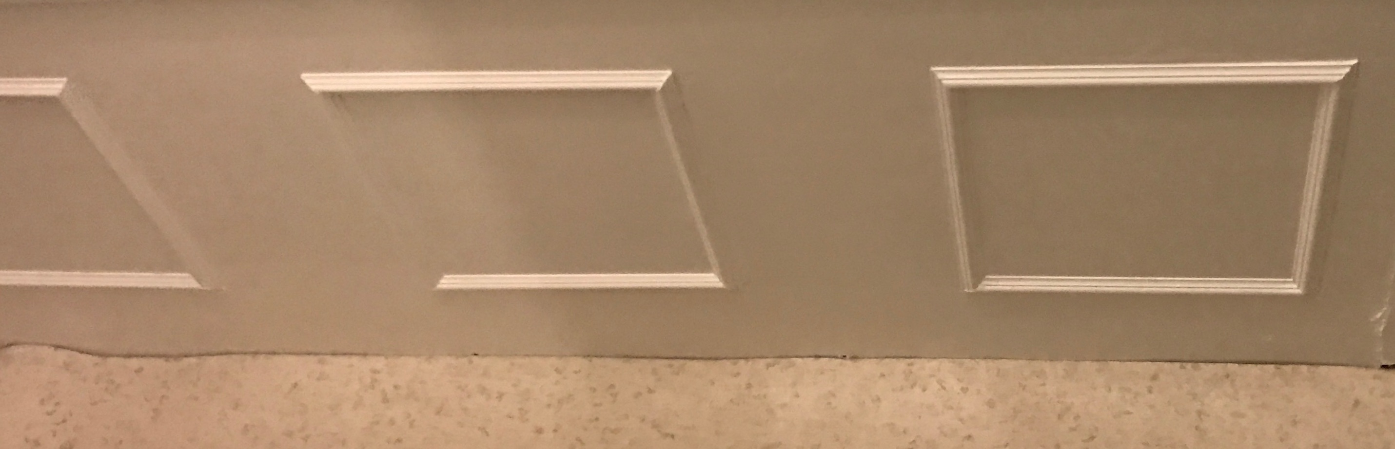

The Bathroom:
I've been decorating the bathroom over this last week and part of this was changing the taps on the bath to include a built in shower. After removing the siding on the bath I discovered it's actually two pieces and there is a large void space (in my case about 16 inches wide by about 18 inches high) it was just big enough to put my small safe (safe is about 1ft square with a key lock).
I managed to cut a small covert access hatch into the bath surround as it has a 14 inch square framed design on the front. I cut the middle out of the frame and fitted it with a magnetic lock.
The false front on the bath surround. The right square is the false one with the magnetic closure.
The safe is secured to the floor in the void space behind the bath and is really well hidden now. It's a little fiddly reaching in to turn the key, but as it's only selected items being kept in it there is no issues regarding getting stuff in and out.
It was surprising how much space was being wasted in the void (and being honest how much still is being wasted) but it's far enough away from the bath not to be affected by any moisture etc from the bath.

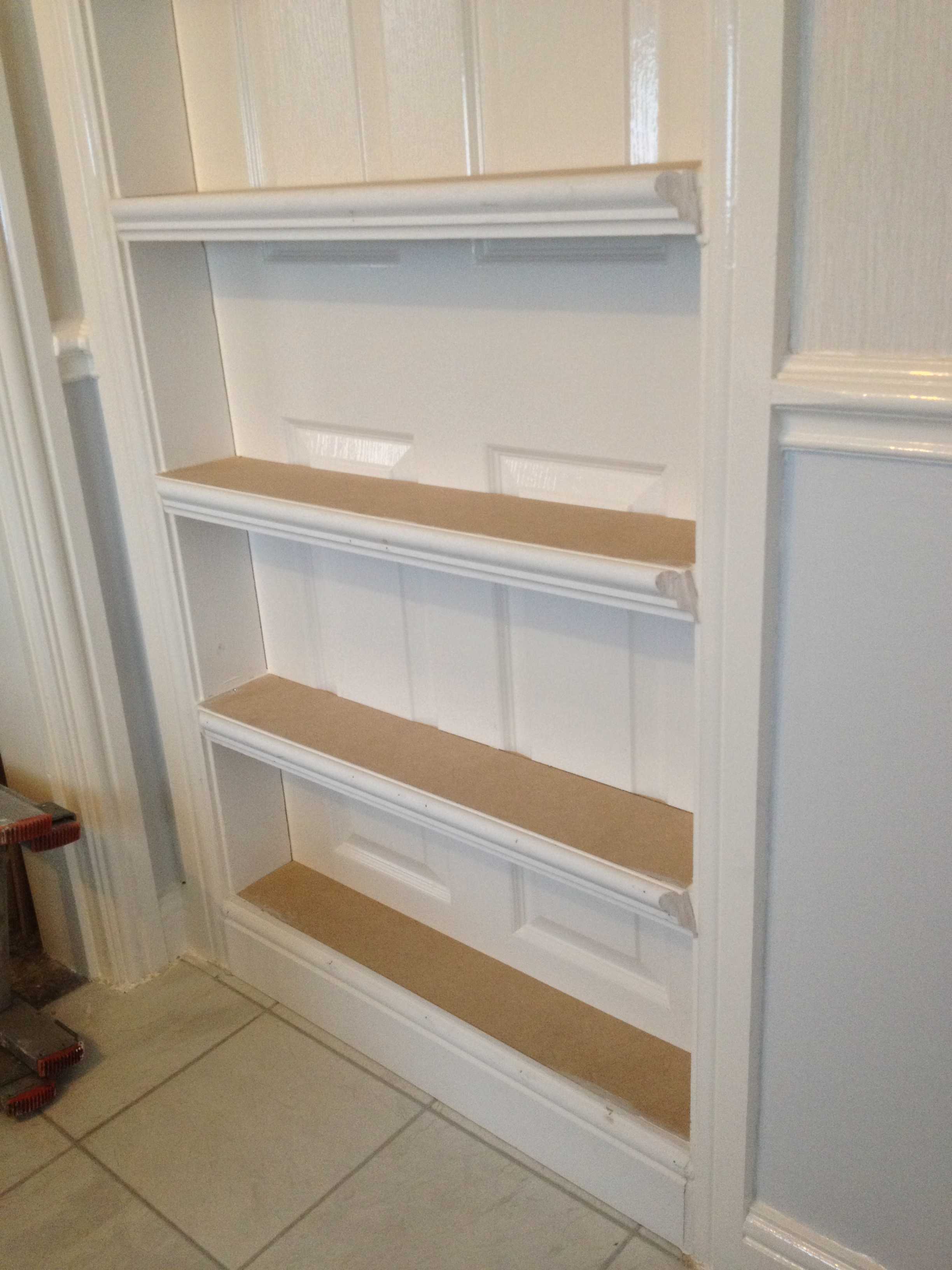

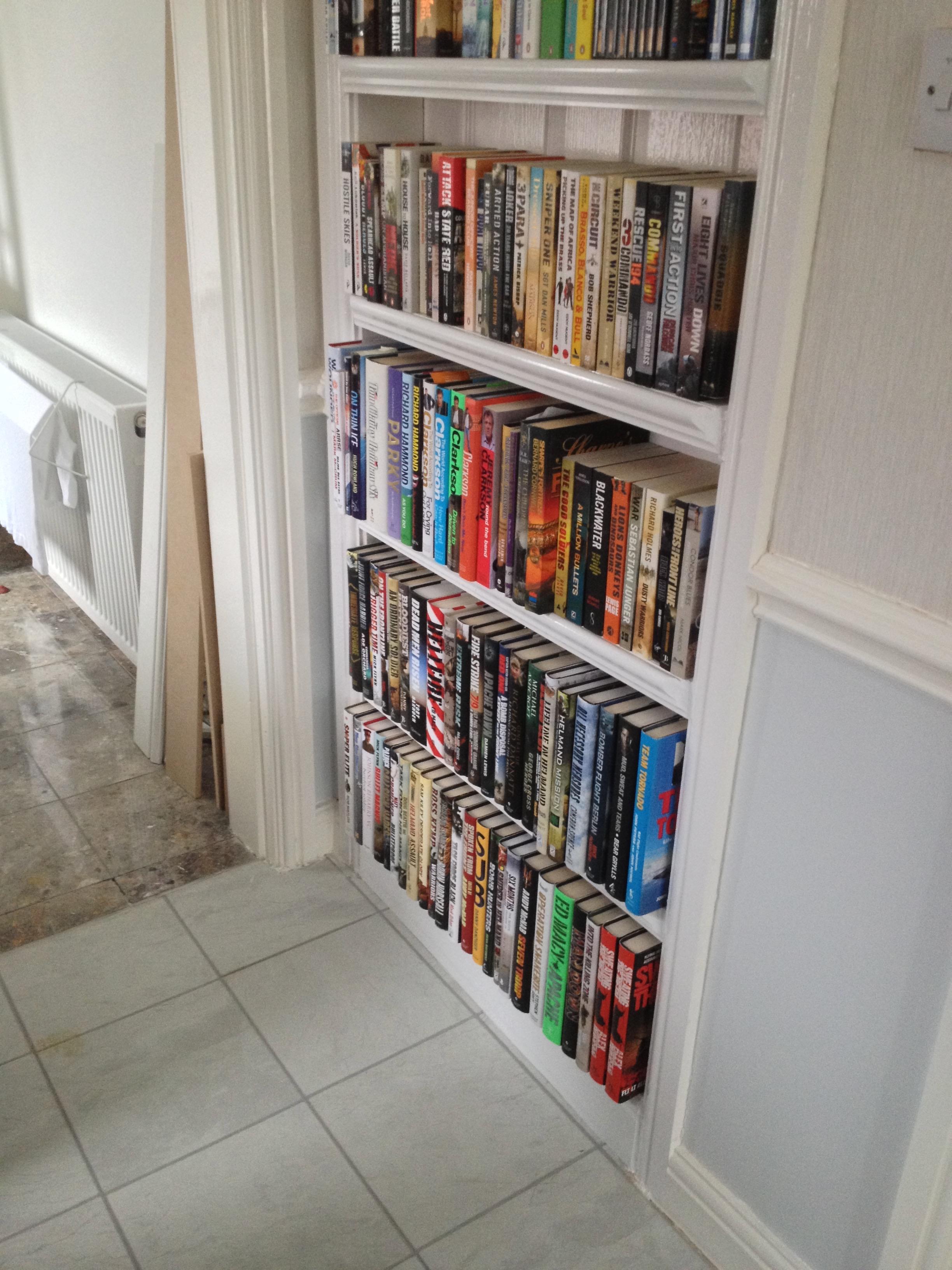

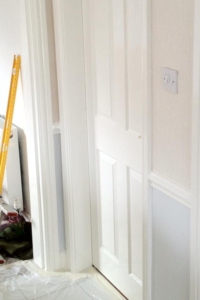

The Bookcase:
The second one is under a built in bookshelf I have made in an old doorway. A few years ago when we moved in we knocked the lounge and dining room through into one large room but never got around to taking out the door as it was hidden in the lounge by a large cabinet in the dining room side.
On the outside of the door frame in the hallway there is a slight instep. As my then desk was in the hallway I fitted a set of built in shelves to put my books on. I put some skirting along the bottom to tie it in with the rest of the hall and put a floating shelf in as the bottom shelf. This has resulted in a nice hidden 'box' for storage of things.
Doorway Before
Doorway Before
During construction with the bottom floating shelf
Finished thing with the hidden secure storage box
So I thought I would share this with you so you can think about void spaces and secure storage.
