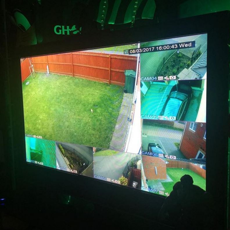

I thoroughly recommend CCTV.
Discreet yet a deterrent. An extra layer of security to my developing fortress that I am very pleased with. Whether it stops crime falling on my property is another matter but from my perspective, CCTV gives me more peace of mind (in conjunction with other security measures).
I have this system and it is great value and comes with 2TB hard drive, remote viewing and 7 day playback. The camera's red night mode LEDs slightly glimmer in the dead of night too which is cool.
https://www.amazon.co.uk/d/Camera-Photo ... s=8ch+cctv
I installed with my brother-in-law. Took us three days and we took our time to run wires through walls, eaves and whatnot so that you cannot see a single wire.
Happy to take any questions.
