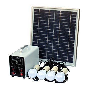

I'm going to attach it the solar generator I built a while ago, I'd rather not use the inverter though so it's going to run through the charge controller direct from the battery. I also would prefer to have proper lightbulbs rather than strip lights which is why I wanted a bulb holder. I can run other thngs from the generator as well so that's not an issue.
Something like this but all I want is the lights!

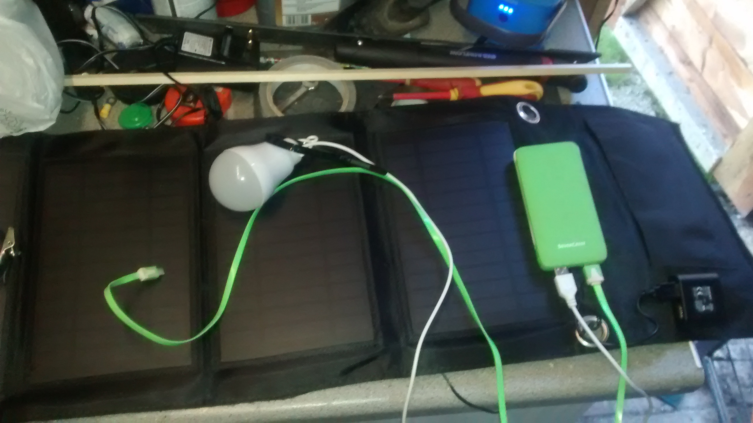

If running off a 12v battery a 12v to 5v usb adapter is all you need

I've already got one of those for camping which is great for camping but not illuminating a living room. :lol: I've already got the battery and panel, I wanted to set up some proper lights permanently. Hence why I just wanted 12V bulb holders. :)
