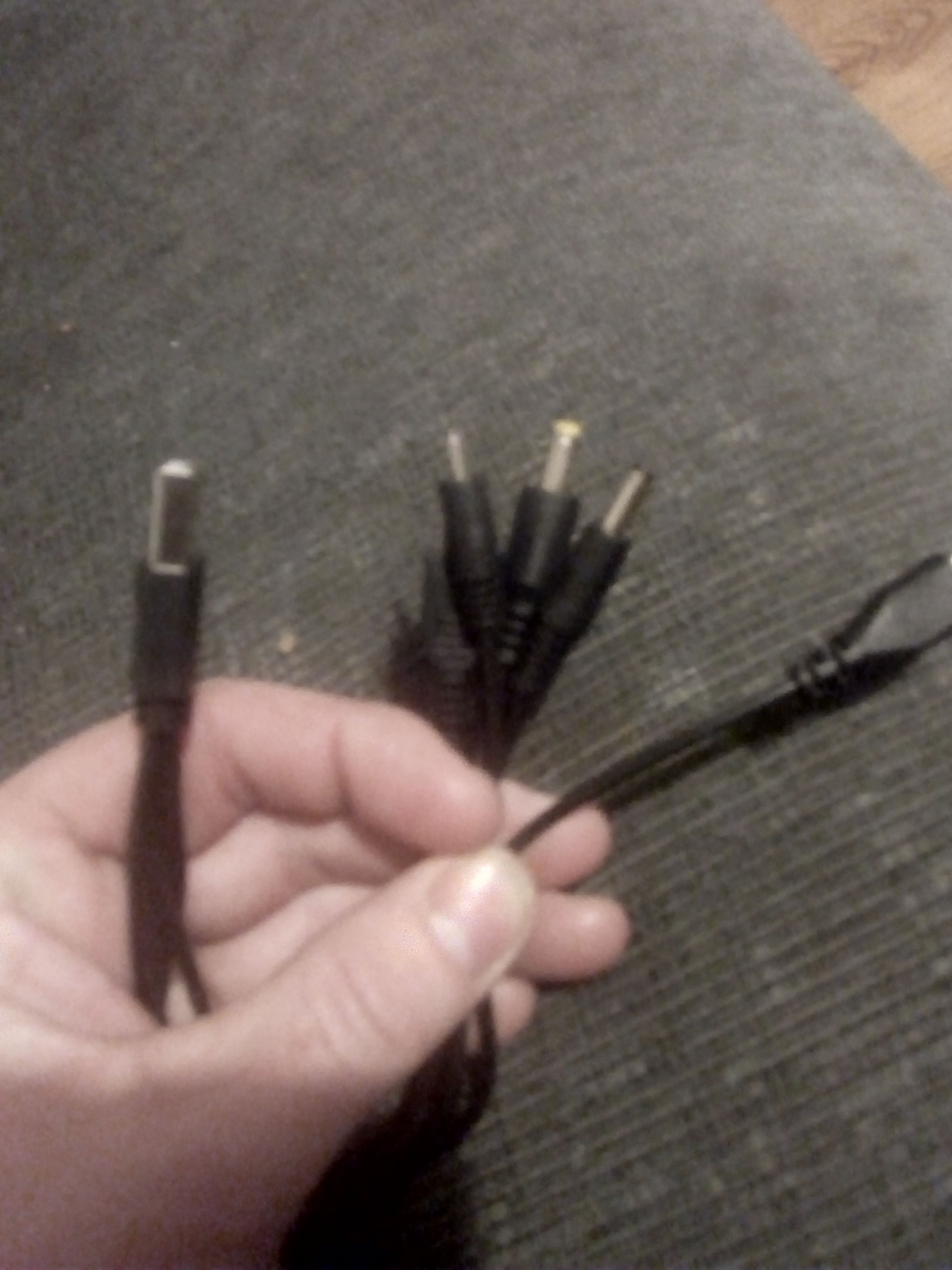

Came with a mains adaptor and can run off four AAs, in the shed I run it off my lifelight solar system that powers my lights, just make sure you get a radio than can run on 5 volts and about half an amp and you can plug it into anything with a USB port, I got the cable off eBay for about 90 pence but I did have to add one of those clip on ferrite things to clean up the supply, the solar panel was acting as an antenna and didn't help DAB reception but with that on there it works perfectly.
If that's a route you want to go down then send me a picture of the mains adaptor and I will find the right cable for you if electrics aren't your thing, you just need to make sure you get the right polarity cable, as it'll likely be a USB to barrel connector that you want and sometimes they're centre negative and sometimes they're centre positive.

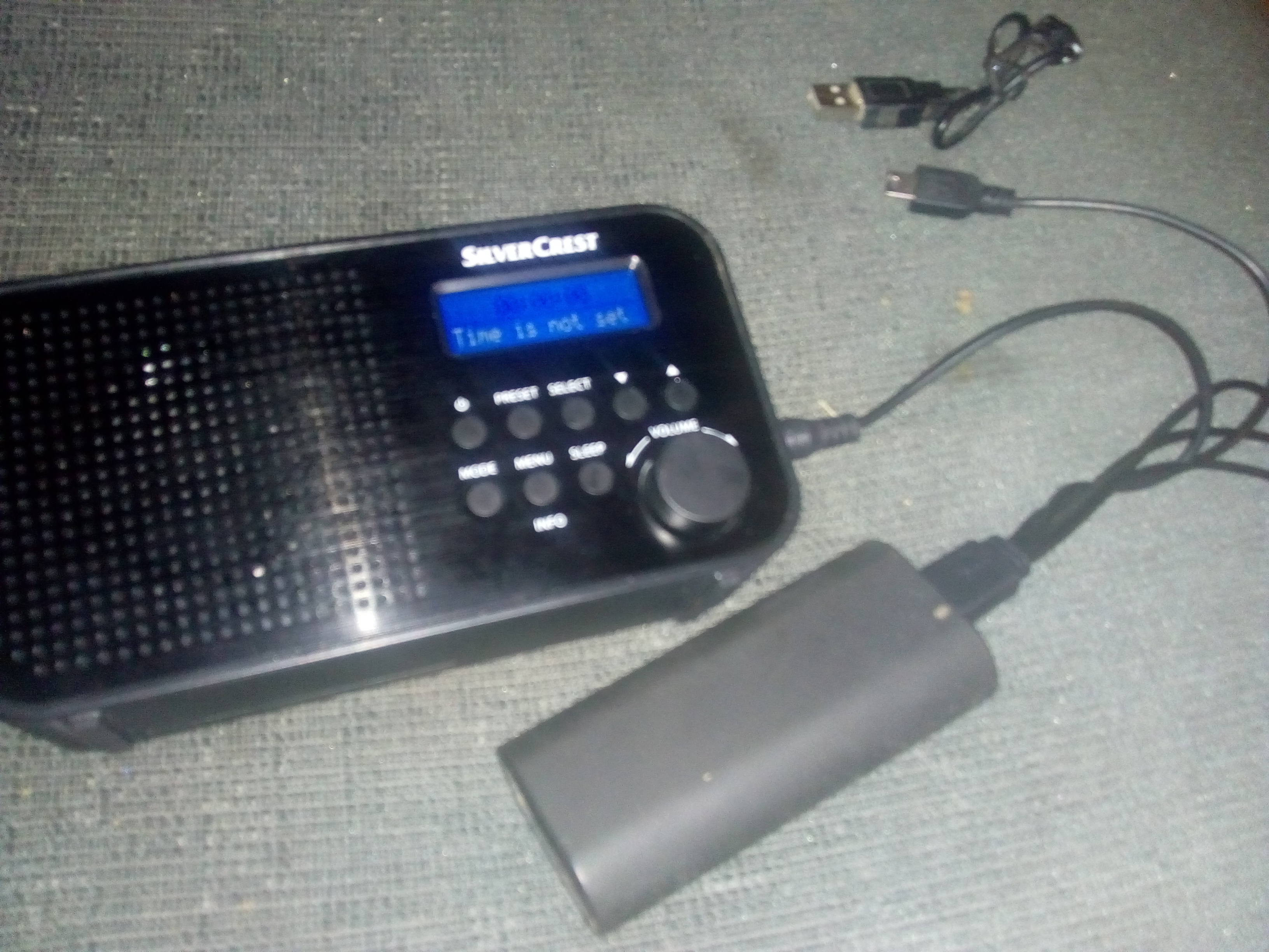

My radio is rated at 6v.
I have one of these
It works fine off a usb supply but some power banks cause mass interference especially to the dab signal

I found my solar interfered, my usual power banks were fine, but then my solar is essentially a power bank anyway.
A ferrite bead that I took off an old camera cable cleaned it up fine, I don't think the power inputs in the radios are very well shielded since they're supposed to run off a fairly clean mains supply but it's easily sorted, you'll either need two smallish ones or wrap the cable through it twice if it's big enough, reception isn't as quite as good as mains or battery but I only lost one or two stations, and my reception isn't great where I am so the signal is a bit weak, a stronger signal would probably get though better.
