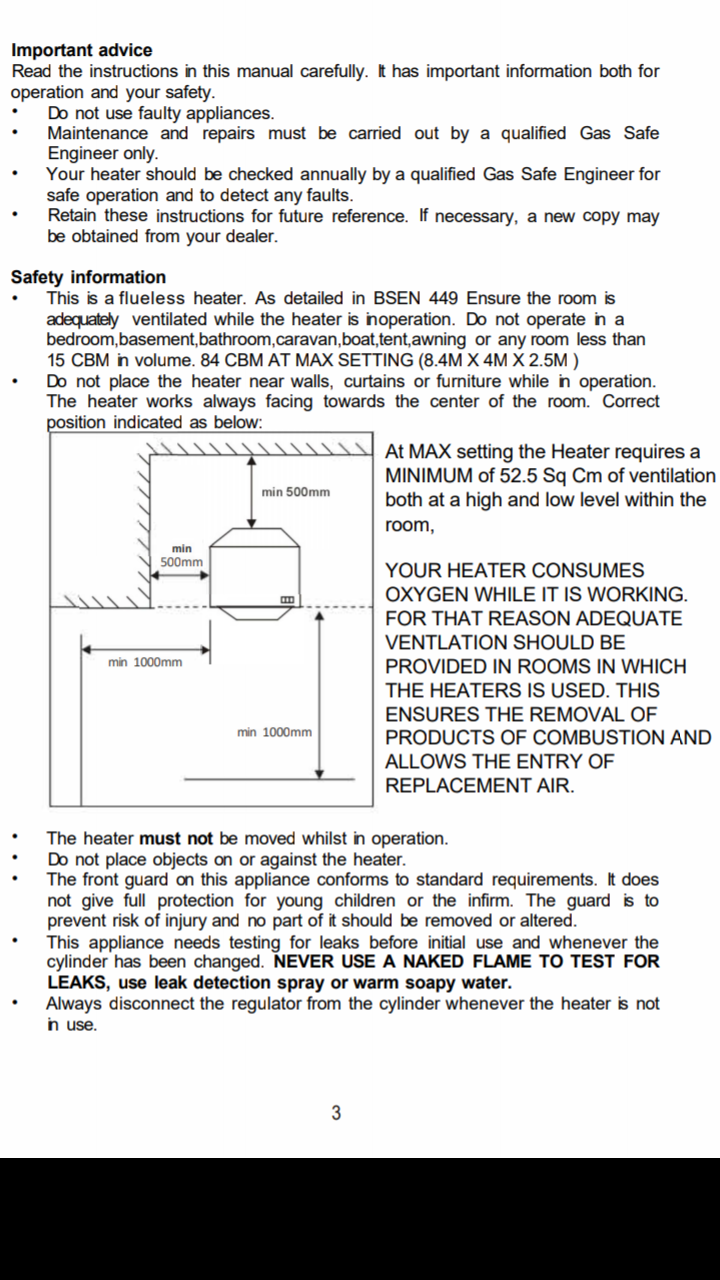

Well kids in bed my new toy came today courtesy of aldi
https://www.rothenberger-industrial.com ... -2000-234/
https://www.aldi.co.uk/portable-gas-hea ... 1246405900
Cirtainly belts out some heat....
One thing puzzling me the likes of calor gas heaters fine to use inside providing you allow specific ventilation eg:
52cm² is next to nothing in terms of vent size for 4kw output
yet every smaller gas heater I've come across has the generic use outside only warning.... Yet this one comes with the same oxygen depletion sensor as per calor gas heaters
Wonder if this is a generic cover their backside warning just like the only use genuine 'A' brand gas it's a generic en417 cartridge for goodness sake ... Almost like vauxhall saying only use shell fuel .....
Yes I know about carbon monoxide... And always use / have decent bsi approved alarm in the living area and it still has a legacy vent from the old back boiler which I keep clean and clear
Mention so much as using a gas stove or heater on a camping forum in a family tent the camping forum residents jump up and down as if your making some form weapon of mass destruction dispite our tent having a area for the cooker....(and ventilation)

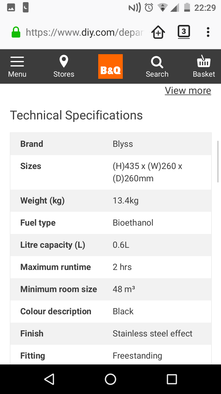

Then you get helpful "advice' from the bio ethanol fireplace manufacturers
Like,:
With no mention of ventilation
Like,:
Or a minimum room size ^12. Do I have to ventilate the room when the fire is on?
Unlike gas or wood-burning fireplaces, there is no need for a flue or chimney in a room with a bio ethanol fireplace. That being said, bio ethanol fires consume some of the oxygen in the room, which means that fresh air needs to be let in once in a while. If the air in the room gets stuffy, the room feels too hot or you experience any headaches or discomfort, simply open a window for a few minutes and leave the door ajar to improve air circulation.
