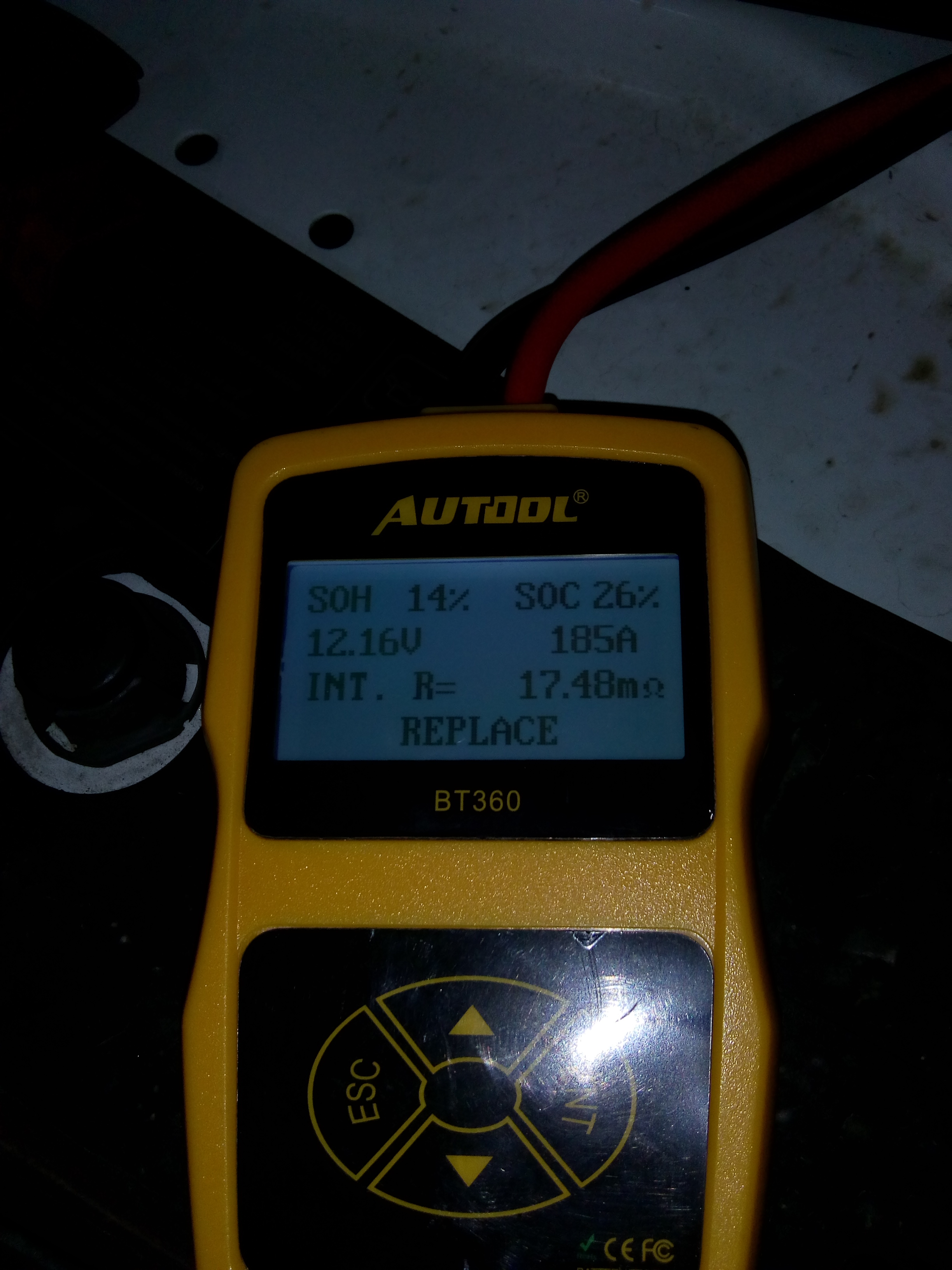

Well the old jalopy has been sluggish cranking past couple of weeks cold on Friday really highlighted this .... Saturday mid morning it was a bit groggy
And out with the batter tester yesterday..
Didn't leave me stranded but guessing if I hadn't replaced it, it would have done shortly

Id get the battery tested (the tester I have cost me £25... I distrust places who offer "free" battery tests
If you have a good local independent garage go ask them to test it .. that unit above also tests cranking and the charge system

Be wary of battery testers, we used a SnapOn one at work and it condemned some decent batteries and passed others that were totalled.
Hook up a multimeter to the battery and test voltage, now turn the engine over, the voltage shouldn't drop by too much, if your battery is healthy do it now, make a note of the voltage drop and when things slow down you have something to compare it to. But depending on the vehicle it shouldn't drop below 11. 9-10 volts and its heading that way, below 9 and its goosed.

Well the tester confirmed my thoughts that it was fubar..
Those who are aware of their car has a good understanding of how it sounds / feels at cranking it's always good for diagnosis... Sisters car had starting issues... Battery tested fine . Using the old school 100a load drop tester soon pointed to a knackered "earth" strap by testing down stream from the battery....
Quick test involving a decent jump lead..... Bingo fault found £20 for a new chassis to gear box link... Good as new.......
