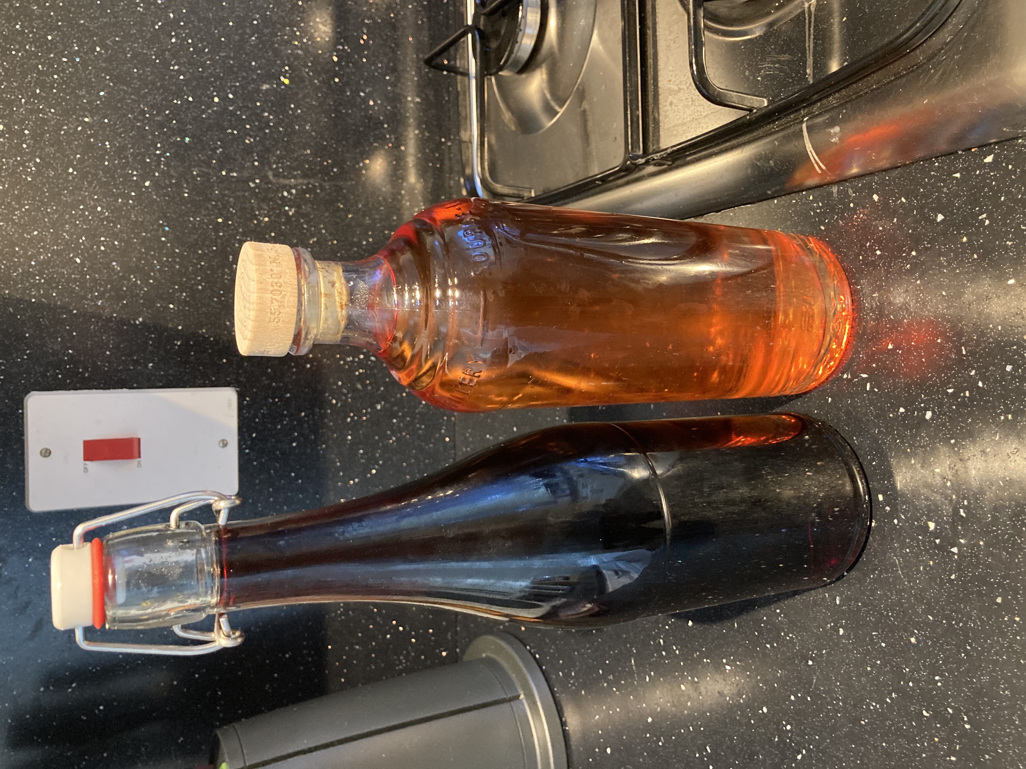

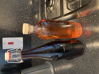

Haven’t a clue if this has attached but that’s my cherry and fruit salad wine.
The fruit salad wine is in an Arran whisky bottle. I’ve told the wife I need more empty bottles for my wine so therefore I need more whisky….

Kiwififer wrote: Fri Feb 25, 2022 5:24 pm
:lol: :lol: :lol:
