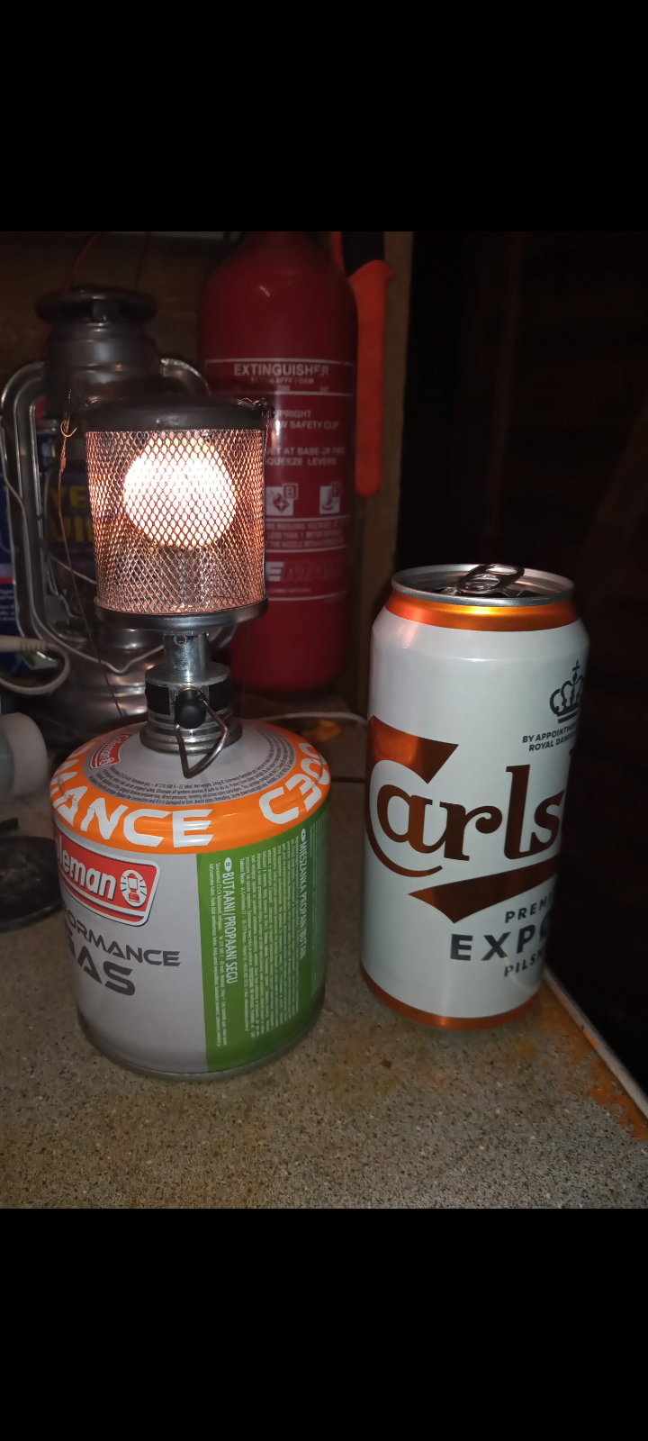

Gas lantern:
there are several types of lanterns available using gas cartridges to big calor type bottles anyone 40 or over will probably remember the big calor bottles on the motorway with the big bullfinch gas burner lights on the roadworks signs down to tiny backpacker lights... For a proper light at home most will go for a intermediate size lantern ... All will require a stock of cartridges to suit the lantern and it's wise to Cary a pack or 2 of spare mantles
As with all combustible fuels there's the risk of fires but they do give off a good amount of light and heat but can be noisy (dull roar of gas )
There are also gas candles emerging but they are more decorative than useful

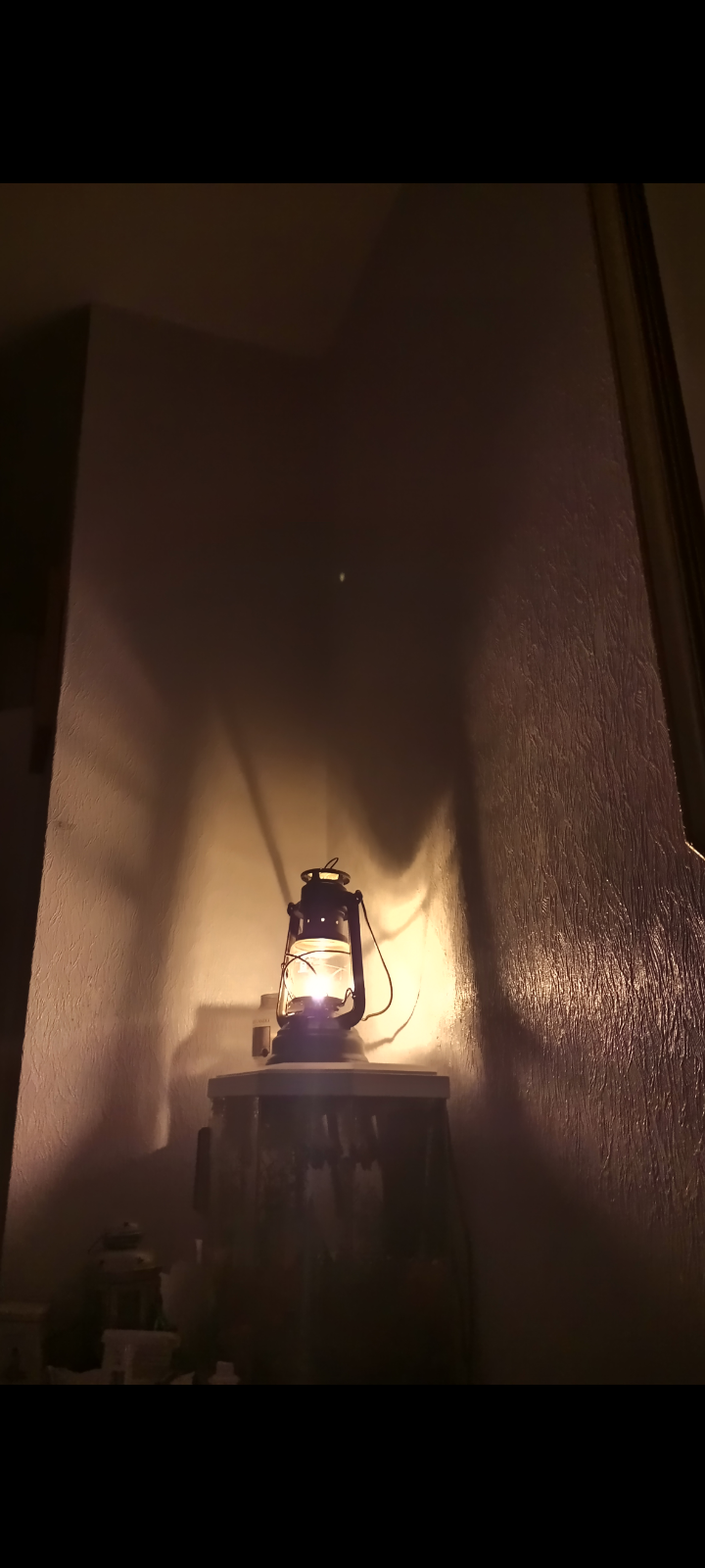

Kerro / parafin / petrol
Few different types but the two basic types passive and pressure...
The more basic relies on a wick think old huricane lamps now I've caused a stir in the past saying the cheap ones are naff but I'll standby my comments the German feuerhand storm lanterns are better quality and parts (wicks and globe's are reasonably available on line) and they don't tend to spring a leak obviously read the lamps info on the correct fuel type needed
Then you've got pressure lamps which generally give out more light but rely on pumping up / pressurising the fuel which gets pre heated/ vapourised before being burned through a mantle ......
Beware of many antiques / older units ensure that they are inspected and all seals are good as age / exposure to fuel can cause them to perish. Or fuel containers to rust inside out ... And the last thing you need in a shtf moment is a pressurised fuel igniting inside your house (had a Coleman twin ring petrol stove spring a leak in a caravan awning years ago pressurised fuel poses a tricky DIY fire fighting problem both a pool fire and a jet of flame from the leaking tap ...
Candles. Well this needs no introduction much safer burned in a candle lantern or decent glass holder poorer light output to a huricane lantern
With all the above ensure shtf and normal time they are away from curtains / accumulated domestic stuff paperwork etc ensure they are not left unattended safe from pets / kids knocking them over and keep suitable fire fighting kit handy ..DO NOT USE WATER ON CANDLES / FUEL OILS

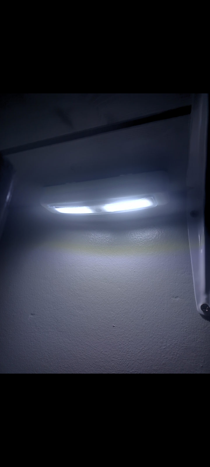

And some glow in the dark tape can be useful if used around the house from that little step into the kitchen or top step of the stairs to the knob to the pantry door where the lantern is stashed power goes out the dull glow will highlight stuff for your convenience ;)
My battery push lights I've dotted round the house all have a strip of glow tape if the lights go out I can find them to start bringing more lighting preps into use ;)
