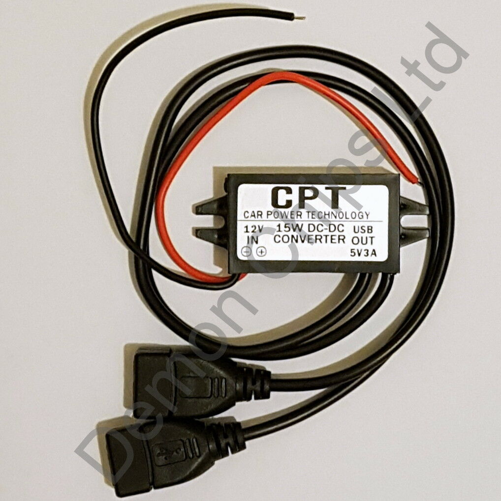

Cheap tool box for a tenner to carry the battery in and a £9 12v to twin USB out
https://www.ebay.co.uk/itm/172980727576 ... R_6D9fnmYA
