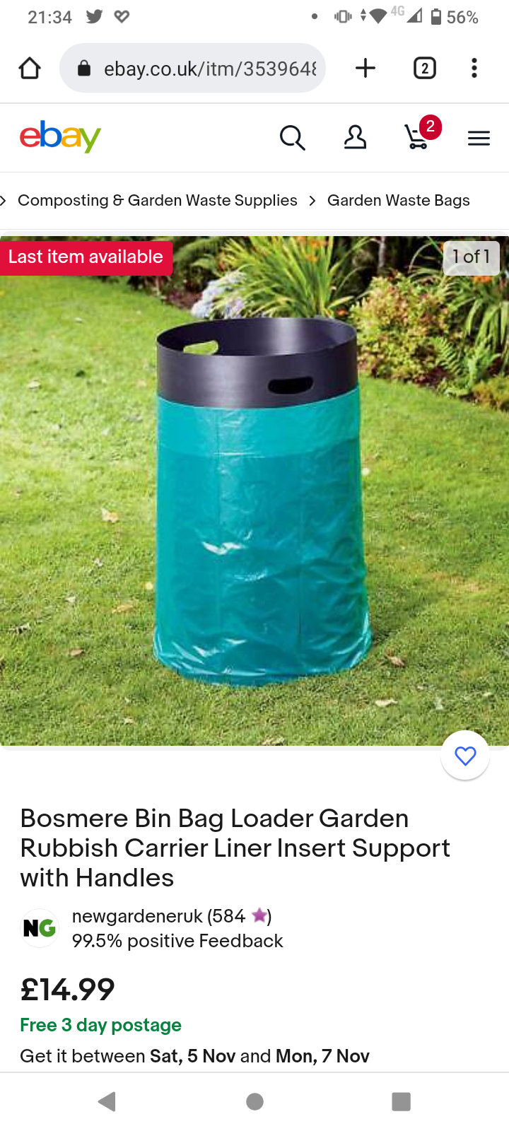

Hessian and polyester woven bags both rot
I've had Hessian ones rot filled in a dry garage...
Likewise the woven plastic jobbies disintegrate in sunlight
Your best having builders merchants bagged sand and sand bags ready to fill a sharp knife and a bq bucket with the bottom cut out and a slit down the side ...
Roll it tighter than the opening of the sandbag slide into the bag then let it go
Something like this
https://www.thesafetysupplycompany.co.u ... 4YQAvD_BwE
