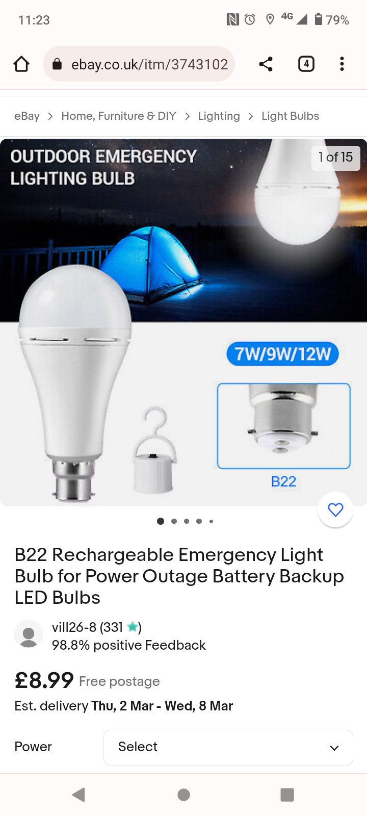

Came across these on eBay
https://www.ebay.co.uk/itm/374310247104 ... BMksiC289h
As a drop in replacement for a standard pendant type light fittings
Available in various wattages / base fittings
They contain a rechargeable cell and a little bit of black magic to make them work ..
They don't work as such on loss of power but with no power they work off the light switch
The ones I got seem to be a cool white light
Put the new bulb put in safely ...
Turn the light on to light the room and charge the unit battery..
In the event of the power going off the unit detects the lightbulb turned on by a high resistance path between live and negative from any plugged in appliances around the home and powers it from the inbuilt battery at a reduced lighting level
Put one in last night but was a bit late to start flicking the power off

They look ideal for a short powercut. The only downside is their battery would discharge in a few hours and presumably it's built in. They'd be great in a kitchen where you want bright light for a relatively short amount of time. How bright are they in batterey mode compared to mains?

I'll let you know it'll get a bit more charge tonight..
It goes on and off with the switch so if you have a power cut and your out .. it'll come on when you flick the switch rather than just light up automatically if the light is off
From reading they won't work on a double bulb set up or say a bathroom with a fan in circuit..

I've had a quick play much to little man's excitement I put it in his room it's nice and bright on mains bit blue been daylight / cool white
It didn't work when I tripped the lighting circuit put MCB back on flicked the main isolator guessing it then found a path between live and negative and worked fine
In battery mode it's bright enough to see by not overwhelming or spectacular but not poor either you can see ok the utter confusion on a 6 year olds face when his is the only light switch working in the house
