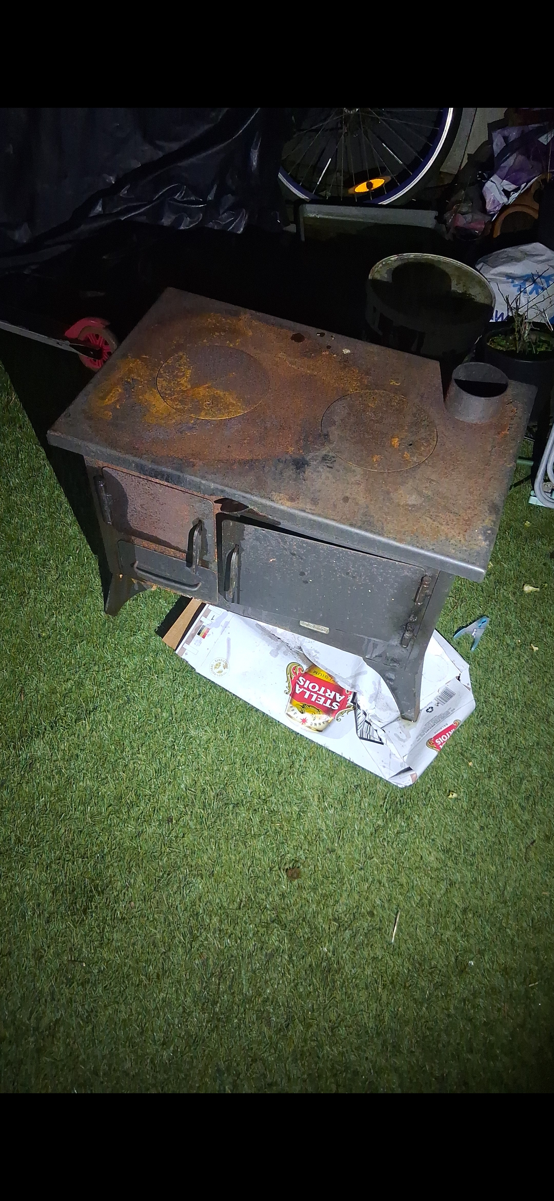

I got given this before it went to the tip as it's rusty and broken..... it was the in-laws it got left outside and the doors rusted shut then they snapped one of the hinge welds....
So one man's scrap and a that.... i still don't think they have fully sussed how actually handy I am with a pile of tools :lol:
Bit of a sorry state

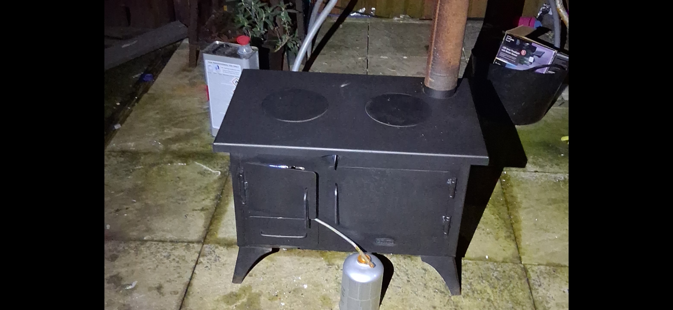

Started by freeing up the hinges with a gas torch running mapp gas and let it draw in some 3 in 1 oil which once it cooled you could hear it cracking the rust ...
Broken weld was ground back and old buzz box welder was pulled out and weld replaced the other hinge weld looked cracked too so it also got ground up and re done..
The burner air control flap was also fettled
Main body hit with a flap disc and solvent wiped warmed up slightly (i did remove my eyebrow doing this should have let the solvent wipe gas off fully first :shock: Fortunately the respirator and safety glasses saved my face ) and enamel vht paint applied

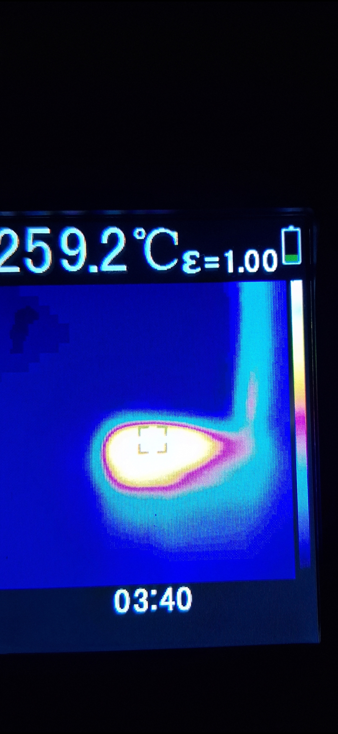

Gas burner was used to slowly bake the new paint the instructions actually say to heat the paint to not more than 200°C to aid curing
£440 new so worth the work
Just the chimney to sort

Just before bed last night I put a small lump of wood in and got the oven chamber upto 120°C
Tonight I'll get the chimney done all being well ..
Did get the fire box end nice and warm

According to the instructions it's 33kg I noticed that when I carried it to the back garden went at it thinking it'd be a lot lighter than the wood fired pizza oven it didn't move ... :lol:
It's got fire bricks surrounding the fire box which add to the heft and hopefully retain heat when restoking
Definitely a home job unless you go camping in a hgv :lol:
