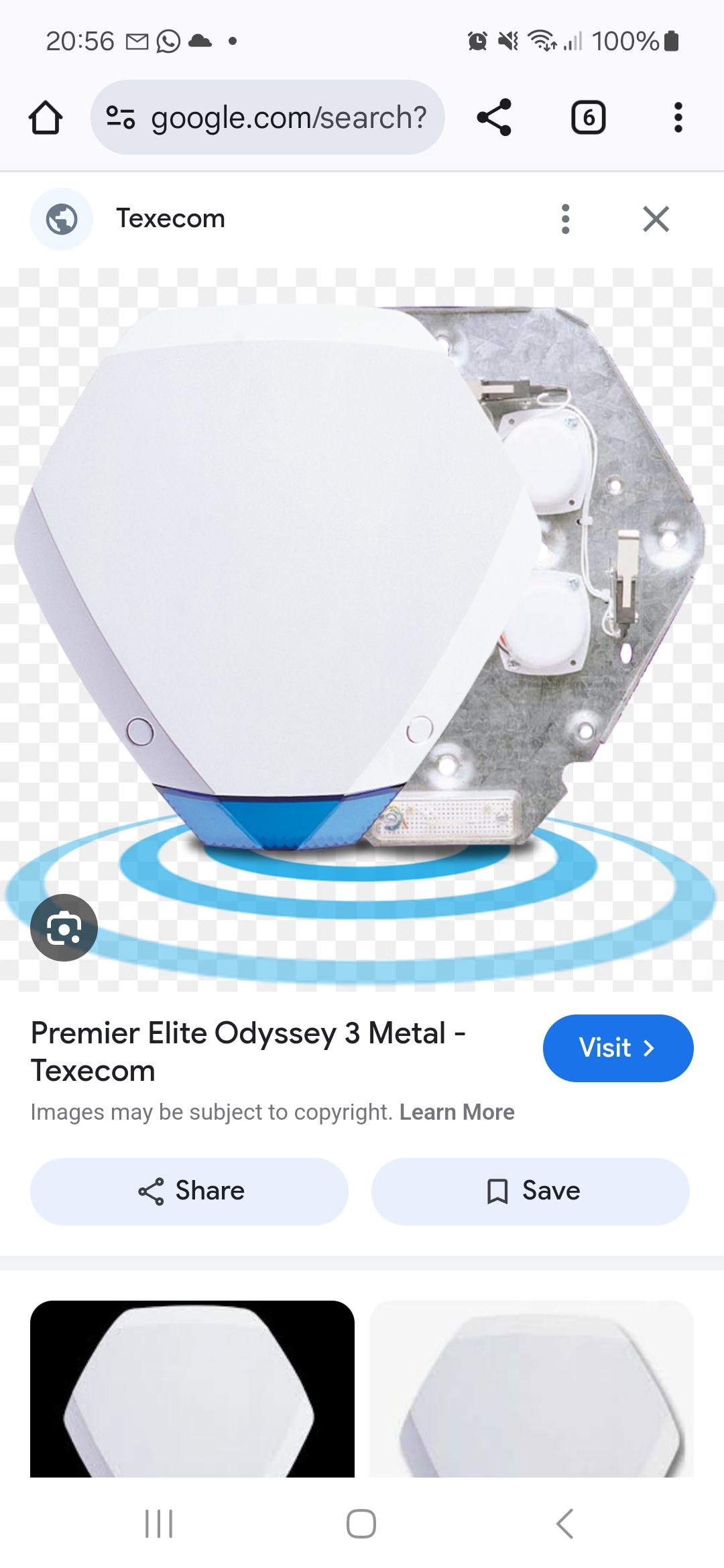

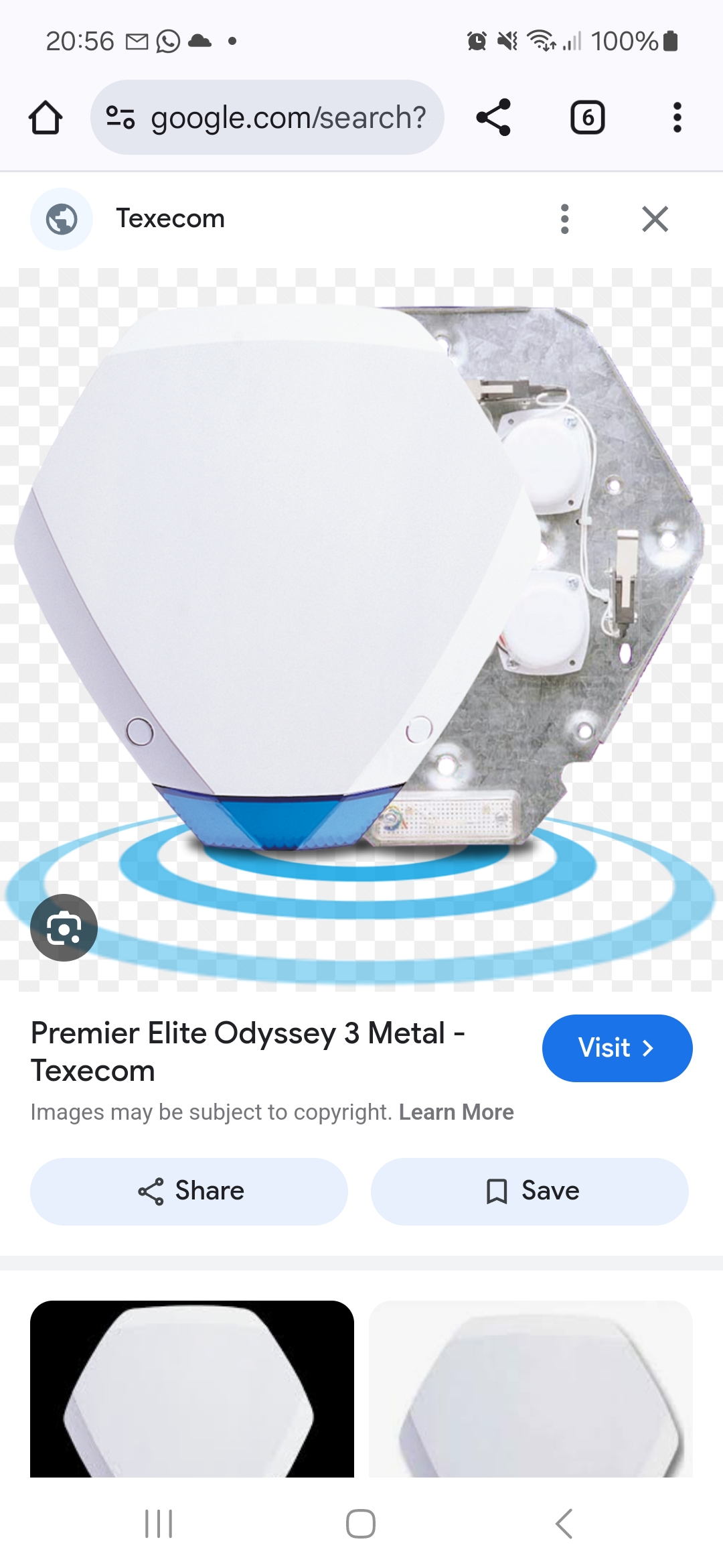

Assuming you mean hard wired not the basic diy smart jobbies
You can get bell boxes with the standard polycarbonate outer skin but below that there's a metal inner skin and long screws meaning it takes an age to kill the sounder....
https://secureforth.co.uk/product/texec ... backplate/
With a standard plastic cover to suit in the colour you want ....
Or full metal back plate and stainless lid
https://norbain.com/elmdene-rapier-exte ... er-grade-3

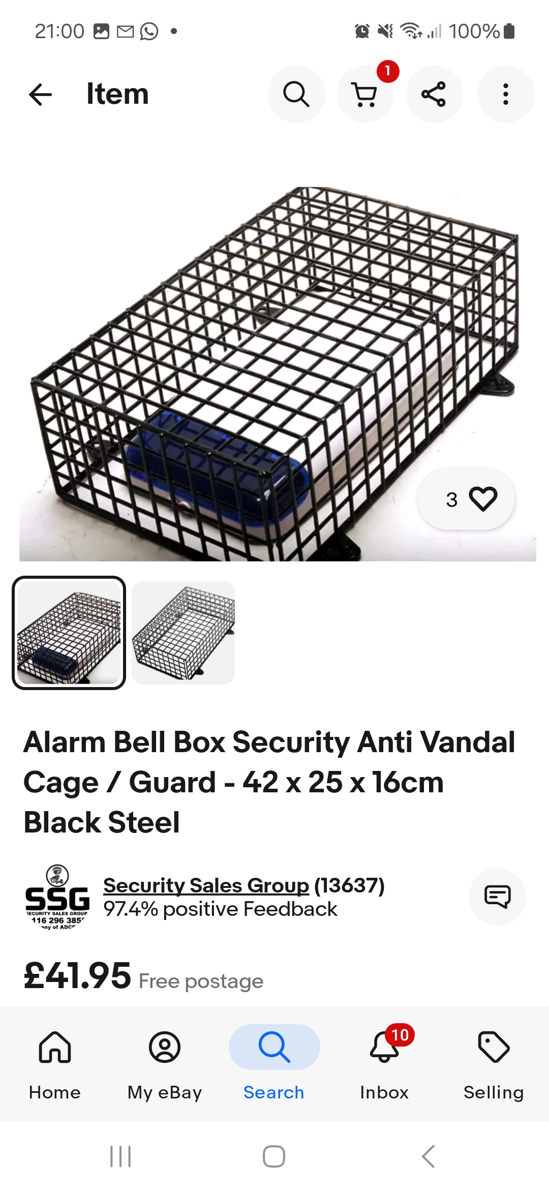

You could make/put an anti-tamper cage around it securely bolted to the brickwork, make sure any cables are not vulnerable.

Peter wrote: ↑Thu Mar 27, 2025 8:49 pm You could make/put an anti-tamper cage around it securely bolted to the brickwork, make sure any cables are not vulnerable.
Joke Alert.......build a chimney then you can get a wood burner.
Not exactly the most aesthetic pleasing solution :lol: OK on a factory or industrial estate
