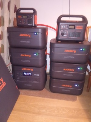

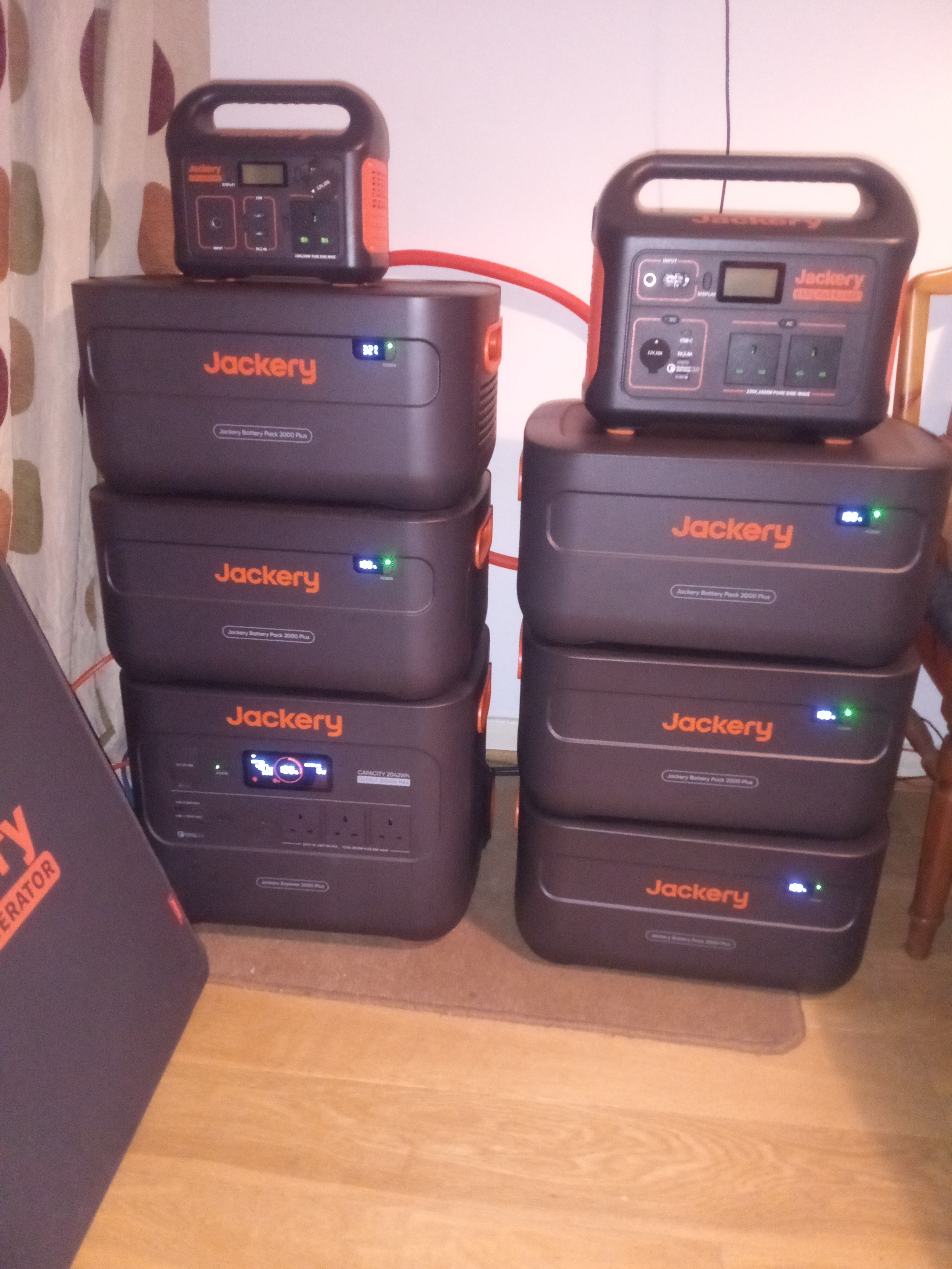

Get one that doesn't require proprietary solar panels, as it can become quite expensive. Preferably one that is expandable.
As other have suggested, work out your usage throughout the day to get your Kwh.
It can be expensive and addictive:
