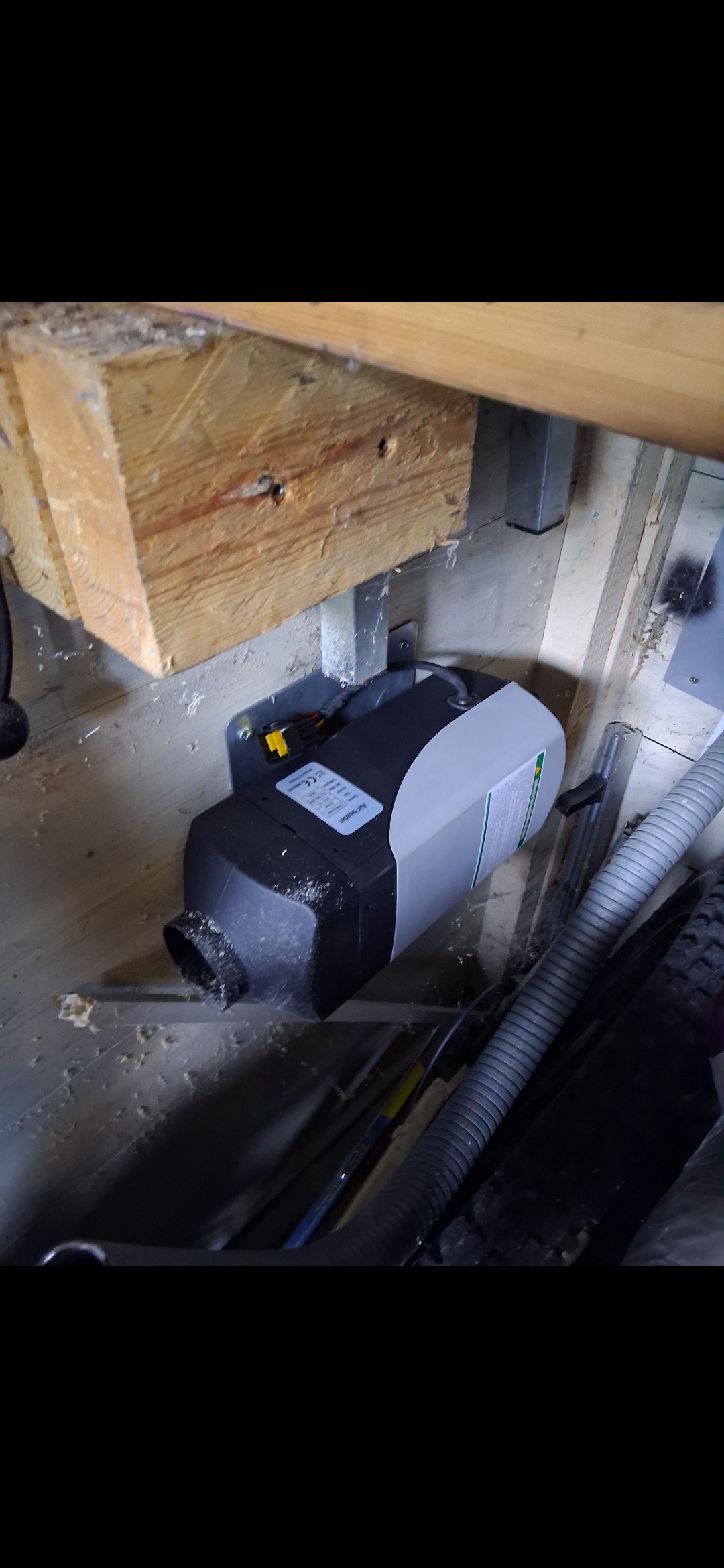

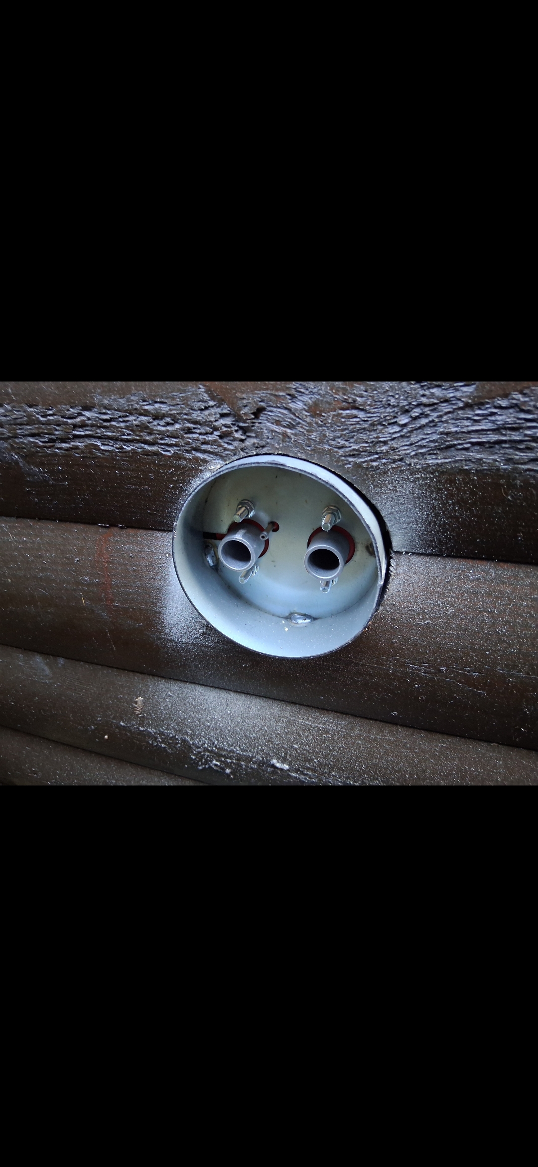

Stick in diesel heater in the shed
They run on 12 v and sip diesel when on
I've a 2kw in my shed side mounted it soon warms it up 8x7ft pent shed the roof is insulated with 25mm celotex
