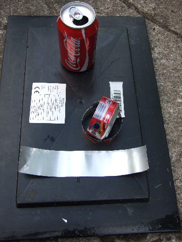

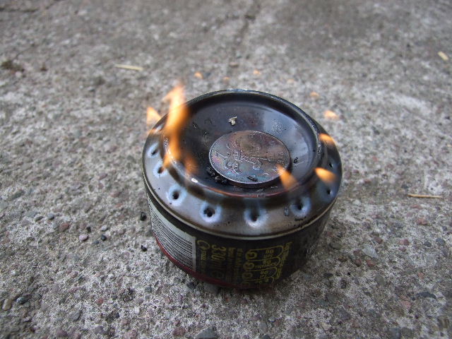

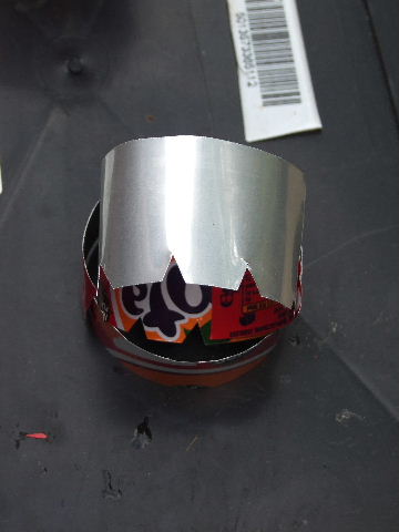

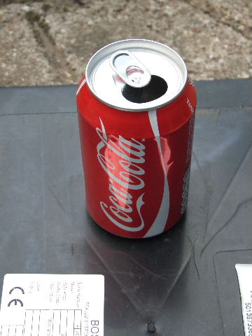

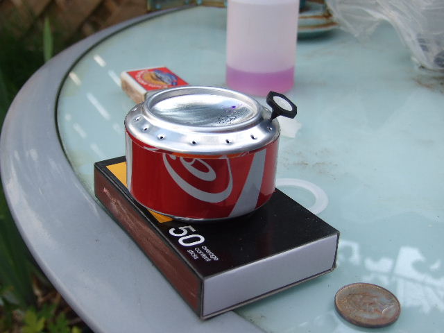

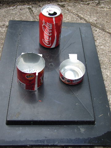

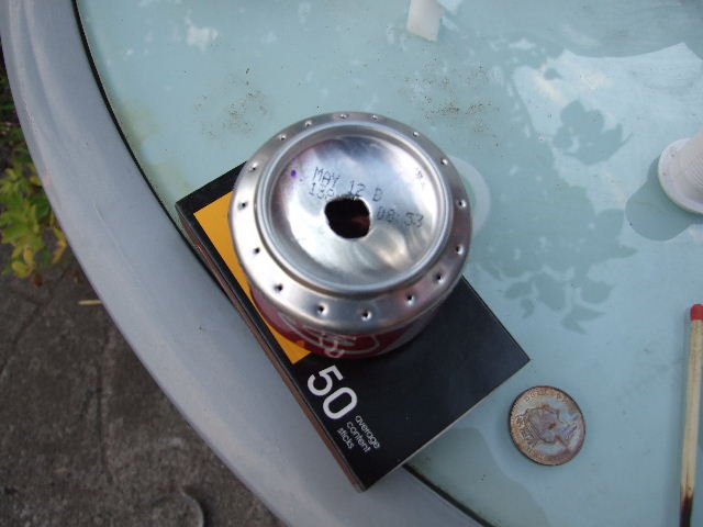

Post by the-gnole »
Here's one I made earlier
DSCF0500 (360x480).jpg (40.72 KiB) Viewed 1116 times
DSCF0501 (360x480).jpg (48.63 KiB) Viewed 1116 times
DSCF0502 (360x480).jpg (44.86 KiB) Viewed 1116 times
DSCF0503 (360x480).jpg (29.54 KiB) Viewed 1116 times
DSCF0506 (640x480).jpg (51.08 KiB) Viewed 1116 times
DSCF0511 (640x480).jpg (51.4 KiB) Viewed 1116 times
DSCF0524 (640x480) (2).jpg (90.87 KiB) Viewed 1116 times

the-gnole
Re: Pop can stove
Post by the-gnole »
nickdutch wrote:You can make another one more simply
1) Remove the top using a knife making sure that the rim is not removed
2) Make a series of small holes about 0.5 CM diameter under rim and on the shoulder of the can
3) make larger holes half way up
4) pour alcohol into can
5) light it, let the fire heat the can and start vaporizing the alcohol
6) place a saucepan on the top (the rim) and flames will start to come out of the smaller holes at the top like gas jets.
Pictures, we need pictures ;)
I built the one above in five minutes to show my daughter how to make one, the Scout troop she is with had tried the night before and failed miserably :roll:
