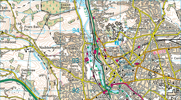

Great idea Ian, I have a copy of Memory Map so can print out any area I want in either 1:50,000 or 1:25,000, with zoom facility as well, with a route planner/marker with flags it would make for easy mapping
So I could take a section like below
small town.png (156.97 KiB) Viewed 1845 times
And put just that bit I need on a shirt :D Excellent idea
