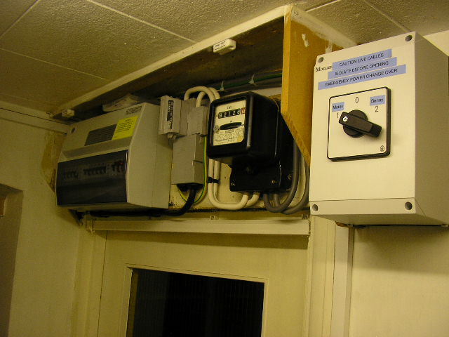

Consumer unit and switchover

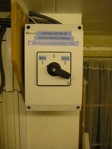

Switchover

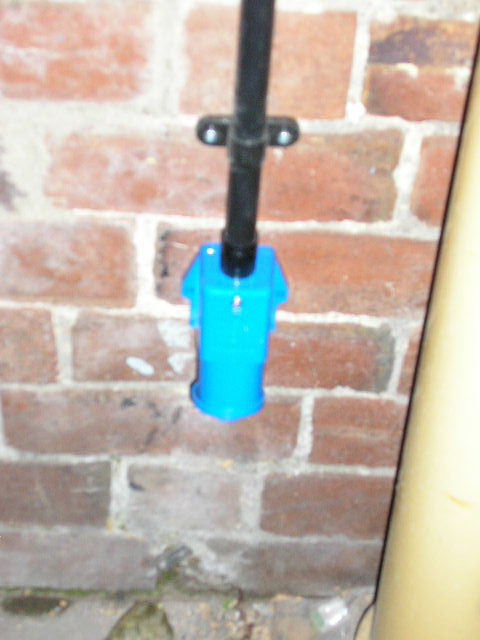

Inlet from Genny
