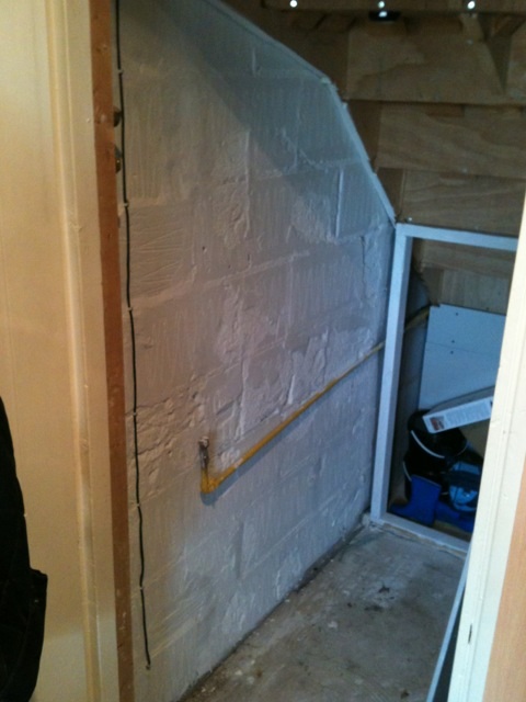

Back in November the boiler finally threw in the towel. So I decided to get a combi-boiler installed, but instead of having it situated where the old one was, I opted to have it fitted in the airing cupboard upstairs. The old one was in the cupboard under the stairs, accessed via the kitchen.
Now the boiler is upstairs, I have a relatively decent storage cupboard under the stairs, no longer exposed to extreme hot/cold conditions.

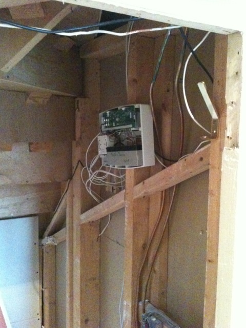

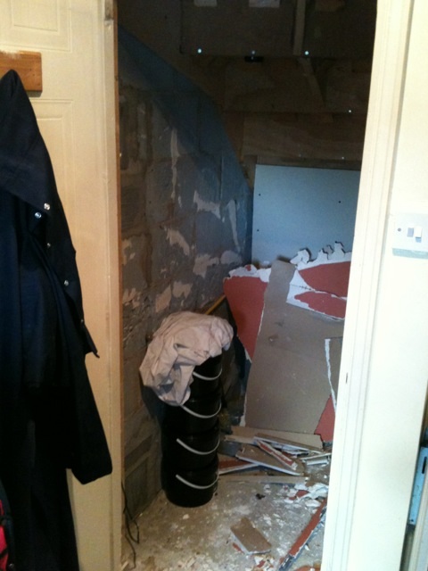

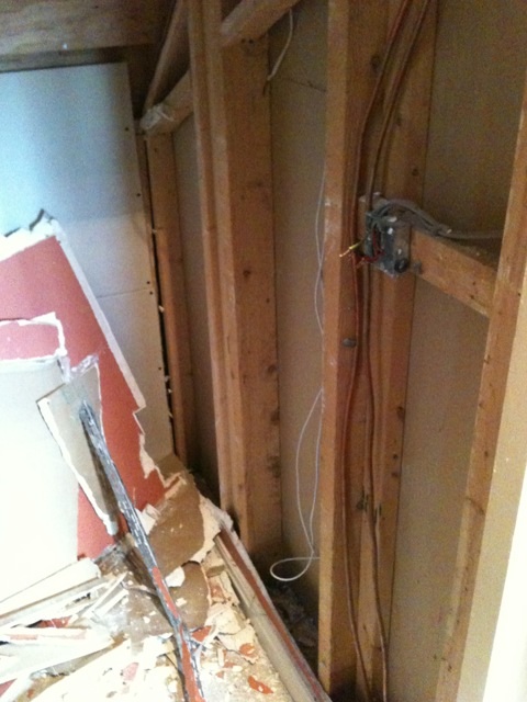

So, queue the pantry project. The following bunch of photos show what I started with (a day or so after I started stripping the space back to blocks & studs) through to having the current grub supplies stored away. Just a bit of decorating/making good left to do.

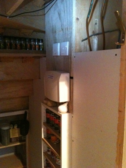

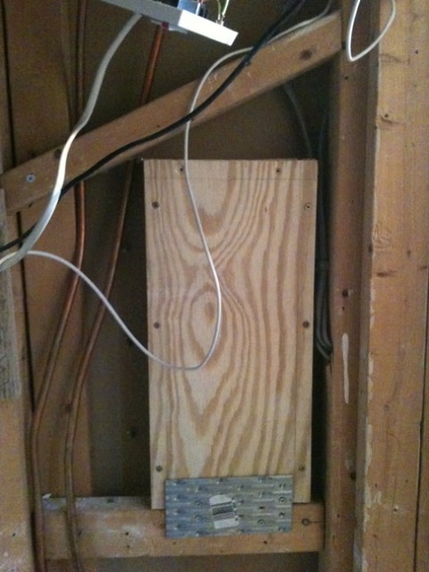

It's an easy enough project, but in this case prolonged by having to remedy messy alarm wiring and brick up a hole left by the boiler. I also fitted a plug socket, purely for future convenience - may use as a charging location for a torch/CB, or something. I'm not an electrician or builder, but I am a keen/experienced DIYer (who knows his limits!) so it probably took me twice as long.

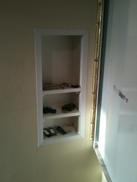

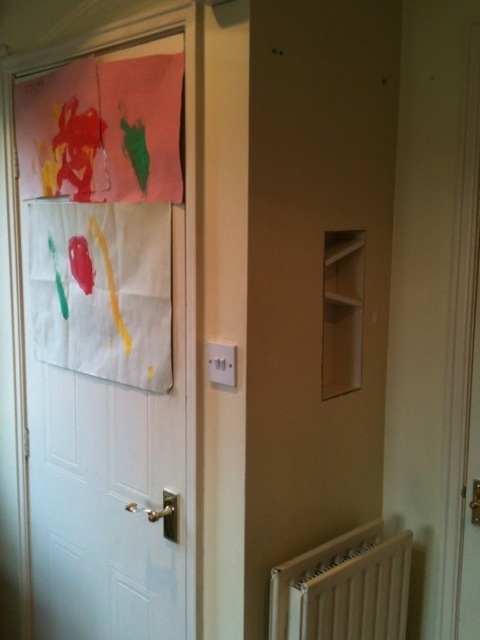

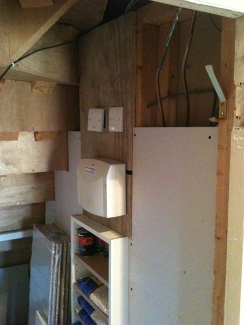

A side project was the creation of a small concealed storage cupboard accessed from the kitchen. I'll put a few pics up of that in a bit.

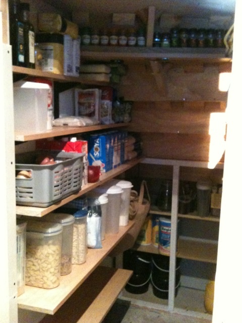

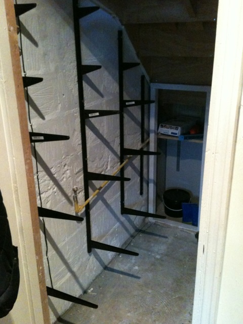

I secured the shelving brackets to the block wall with resin (Fischer P380C) & 8mm threaded bar, aka the mother of wall fixing solutions! There'll be no dodgy wall plug weak spots.

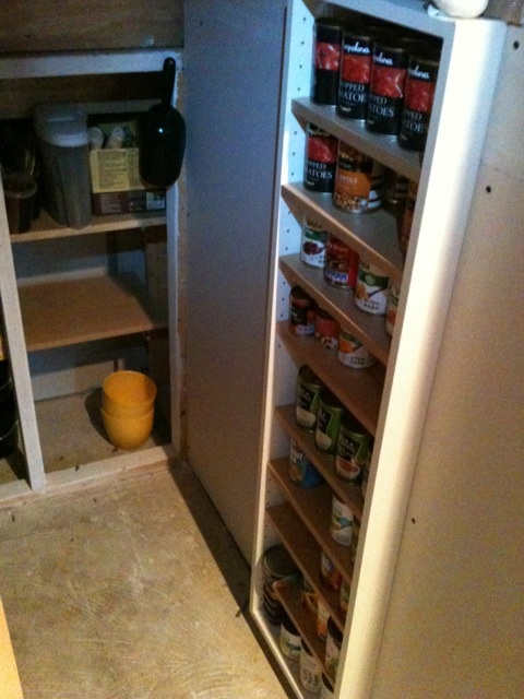

The 'can' storage shelving is a modified Ikea CD storage unit (£20). I opted for this as it offered accurate pre-drilled holes, perfect for adjustable shelving and something I couldn't easily achieve. It holds about 72 cans.
Really pleased with the end result. Easily doubled our kitchen storage space and now have the ability to build up some food storage - we're new to prepping so currently aiming for a 1 month food supply. The temperature seems really stable in there, much cooler at the bottom which is where the veg will hang out. Total cost was c. £50, but then I had a lot of the stuff I needed lying about.
Next project - loft shelving for storing non perishable stuff not affected too much by temperature ups and downs i.e. camping gear, some tools, out of season clothing etc.
Sorry this is such a mammoth posting, but I've been inspired by stuff in the forum and hope I can in turn help someone else take on a project.

Here's the concealed cupboard pics -

All I can say is ,,,,, Nice :D :D :D :D

That looks really good, are you going to add extension boards to the underside of the treads so you can have a shelf on each step :mrgreen:

12mp82 wrote:That looks really good, are you going to add extension boards to the underside of the treads so you can have a shelf on each step :mrgreen:
Quite possibly, but I've no need just yet. I can also slot in another Ikea unit to the left of the current one for more can storage. But again, no need just yet. Establishing stores isn't as easy as I thought!
