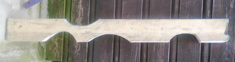

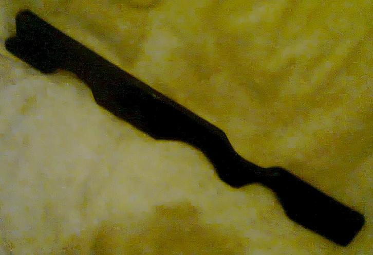

Hi all - bit of a touchy subject this but i have been following backyardbowyer on youtube and followed his 100 lb crossbow plans here it is so far !!
initial cuts from a 2x4.jpg (37 KiB) Viewed 12451 times
quick sand and a first coat of black paint !.jpg (51.27 KiB) Viewed 12451 times
My brother in law has said that this wasnt good enough and a borrowed his sanders and sanded it down yet a gain, and may i say he was right !!
Next i need to source some hardwood dowel to make the trigger mechanism and prod attatchment ..
Then i need to find some 1 1/4 " waste pipe to make the pvc prod..
Will post more as i do it !
