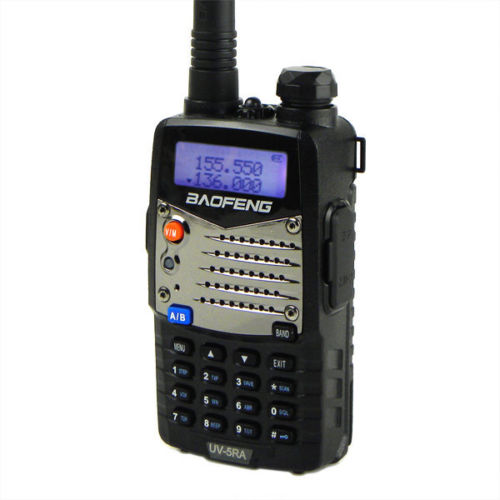

Exciting things are happening to CB this year, so that is one direction well worth heading down. But handheld CBs are not and probably never will be that great, so if you want something that you can stow in your bag you can't really go far wrong with one of these:
They are very inexpensive but not bad quality. The model number is UV5RA and if you search in eBay you will find dozens.
If you buy one and want it programming I am happy to help, but you can use them "out of the box" by just keying in the frequency you want to use.
These will also pick up broadcast radio. There are high performance antennae available, as well as AAA and AA battery packs.

Thanks for the recommendation. Though I have a question. I have had a look on Ebay and one of the sellers lists it as being able to receive frequencies 136 to 174 MHz and 400 to 480MHz yet some of the frequencies you listed on your other thread were outside these brackets. Please can you clarify, can this model receive all the frequencies you have previously listed?

The reason I started this thread rather than posting the info on this product in the list is that no, this radio will not pick up all of the noteworthy frequencies.
The ones I gave here all fall into this radio's capabilities, but notably this will not do airband sadly.

Does it pick up Dab Radio?

Sadly not, analogue signals only.

Even if it is quite a bit more expensive, please could you recommend one that will cover all the frequencies you listed?

I do not know of a handheld that will receive over that many, there are base stations that will. But I know of no single unit that will transmit across that many bands.
Not saying they don't exist, but I have never used or sold them.

The benefits of this radio are not that they do everything, but that they are cheap, powerful, versatile & small.
Sadly the audio quality is not perfect, the buttons rub off too easily and various other minor niggles. But in terms of value they are great.
The band not covered that would be nice to have, aviation, is actually not that useful. Search and rescue 'craft will have capabilities to communicate in the maritime band (156-160) and that is well within this and similar products range.
CB is too far away from VHF and UHF to be practical in one device, though I have seen it in very expensive setups but then there is always another compromise!
