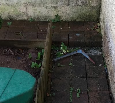

From where it's gonna sit to the path if I used the concrete blocks it's was gonna be 6inch higher than the path. Trying to load a picture up but it's too big . Its gonna go next to my brick shed and brick wall dividing the neighbours and mine garden.
There will be a gap of one of those red bricks between wall to IBC
