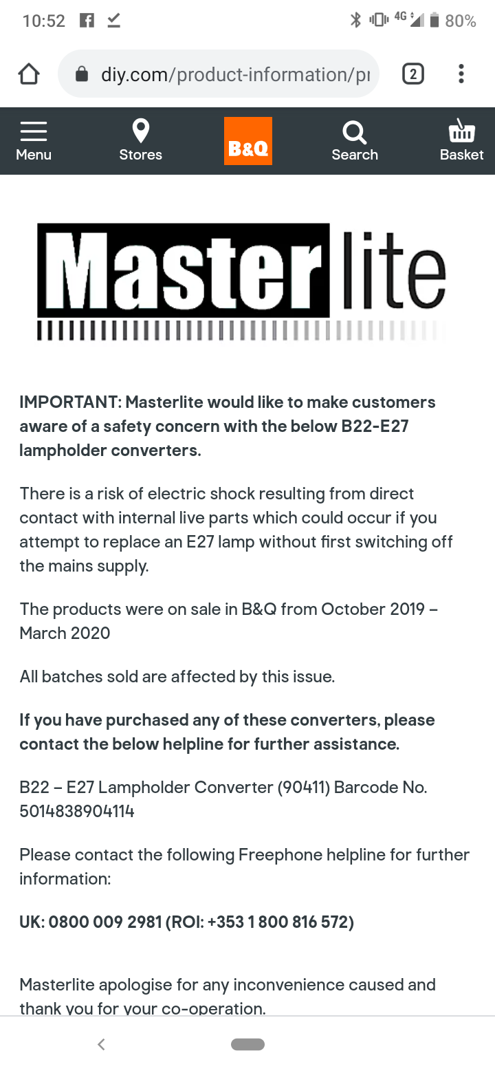

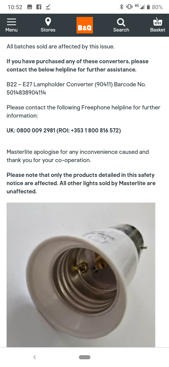

Just a heads up with those they are potentially lethal..... On ES fittings the neutral is connected to the outer screw shroud ... The centre pin live.....
You've got a 50 50 chance of getting it back to front with no warning and a fingertip in the wrong place as you screw in the bulb or a light shade frame coming adrift has the potential to be come live

I really struggle to believe that that is true. Can you help me verify?
Posts: 9853
Re: bayonet fitting light bulbs
It won't be the first time I've come across houses with switched neg at the light switch so even with the light off there's been 230vac at the fitting.... One old house we had to get the dno out as the main incomers were reversed

In another life I was an electrician, Yorkshire Andy is right ( A knowledgeable chap in general), I have to say, unless you know what you're doing and what not to touch, turn off the lighting circuit at the consumer unit when changing lamps especially ES ones, even if you only get a tingle you could easily fall off the ladders ;)

Interesting. I inferred from your post that there was an issue with the imports rather than a structural/design issue with screw fittings. That is really interesting.
