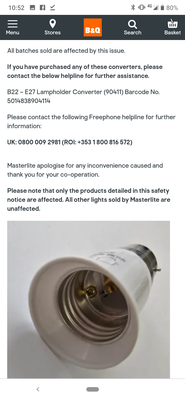

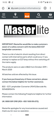

Just a heads up with those they are potentially lethal..... On ES fittings the neutral is connected to the outer screw shroud ... The centre pin live.....
You've got a 50 50 chance of getting it back to front with no warning and a fingertip in the wrong place as you screw in the bulb or a light shade frame coming adrift has the potential to be come live

I really struggle to believe that that is true. Can you help me verify?

It won't be the first time I've come across houses with switched neg at the light switch so even with the light off there's been 230vac at the fitting.... One old house we had to get the dno out as the main incomers were reversed
