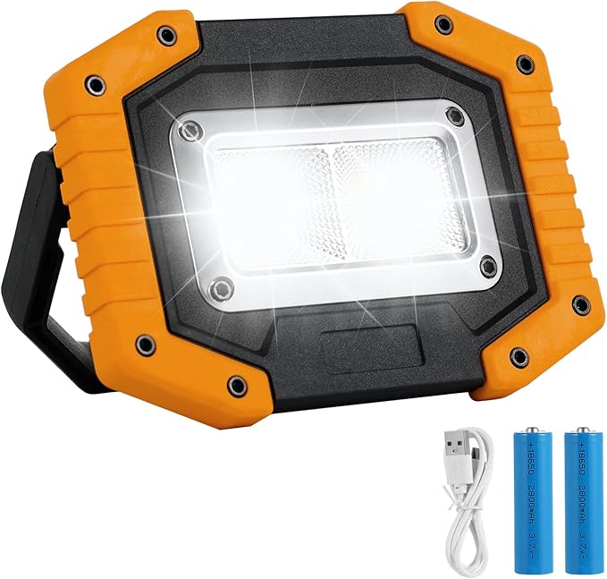

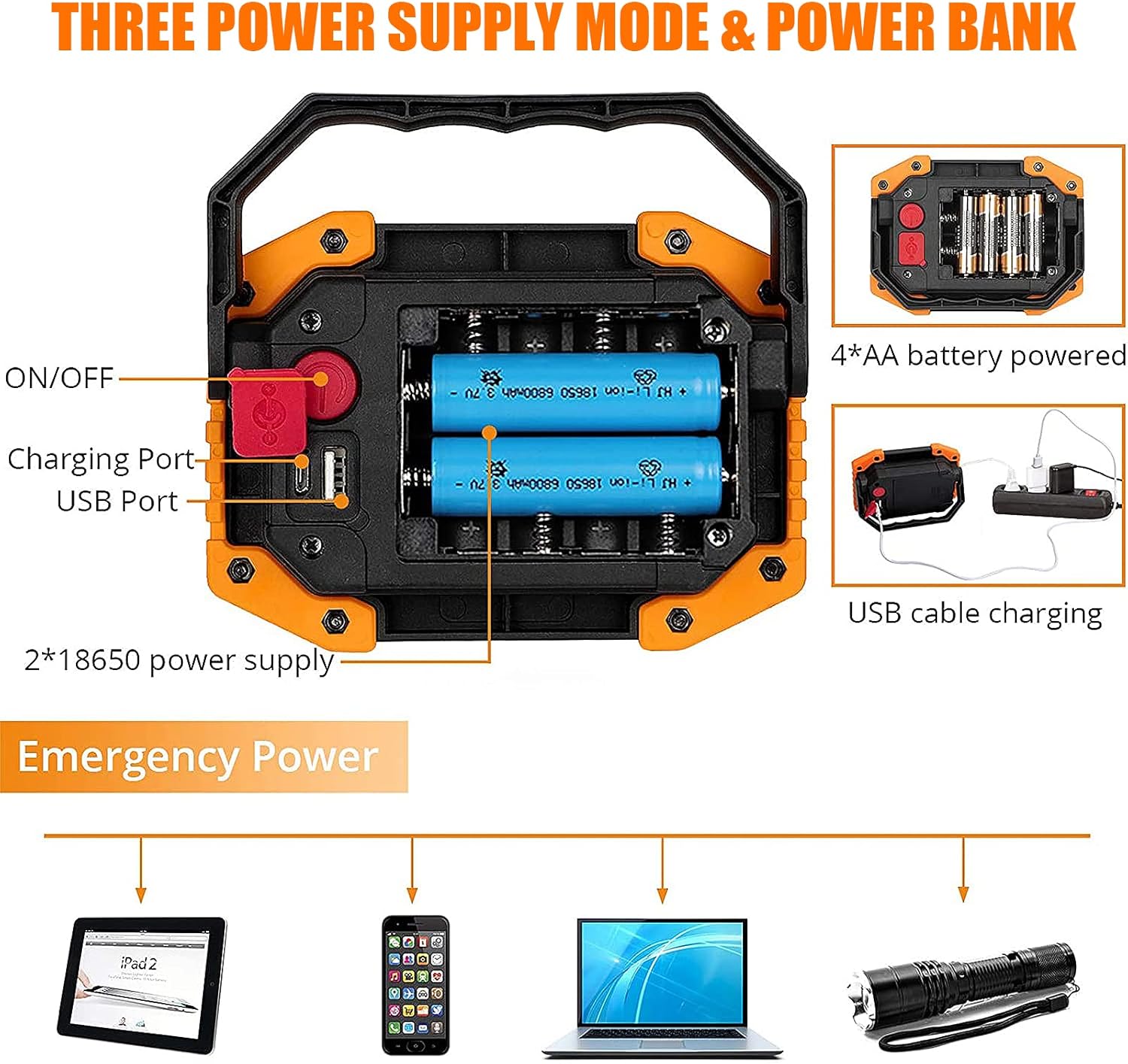

I've a suggestion for a cheap way of implementing a USB powerbank, AA charger and 18650 charger all in one. Indeed, it's almost a free solution ( about £15 or £25 for two ) :-
£15 gets you one bright LED lamp with all these features built in, even includes 2 x 18650 batteries.
Various amazon sellers, some sell these in pairs: Some include or exclude the 18650 cells.
Feature all the functionalonality of a USB power bank. Links below.
The lamps will work off one or two 18650's (Included) or four AA cells. It can be charged by any USB-A source and can be used to power any USB-A or micro USB device. Sadly they don't feature USB-C.
If you're thinking of charging AA cells and/or 18650 cells, and want all that functionality in-one place, you won't go far wrong with this.
Amazon prices and specs change, so check before buying any of these, especially that they include the batteries.
These great little lamps are cheap and cheerful and not very rain resistant. The 18650s are low capacity.
Link to a specific seller, which may expire
Link to the search terms to find these lamps.
