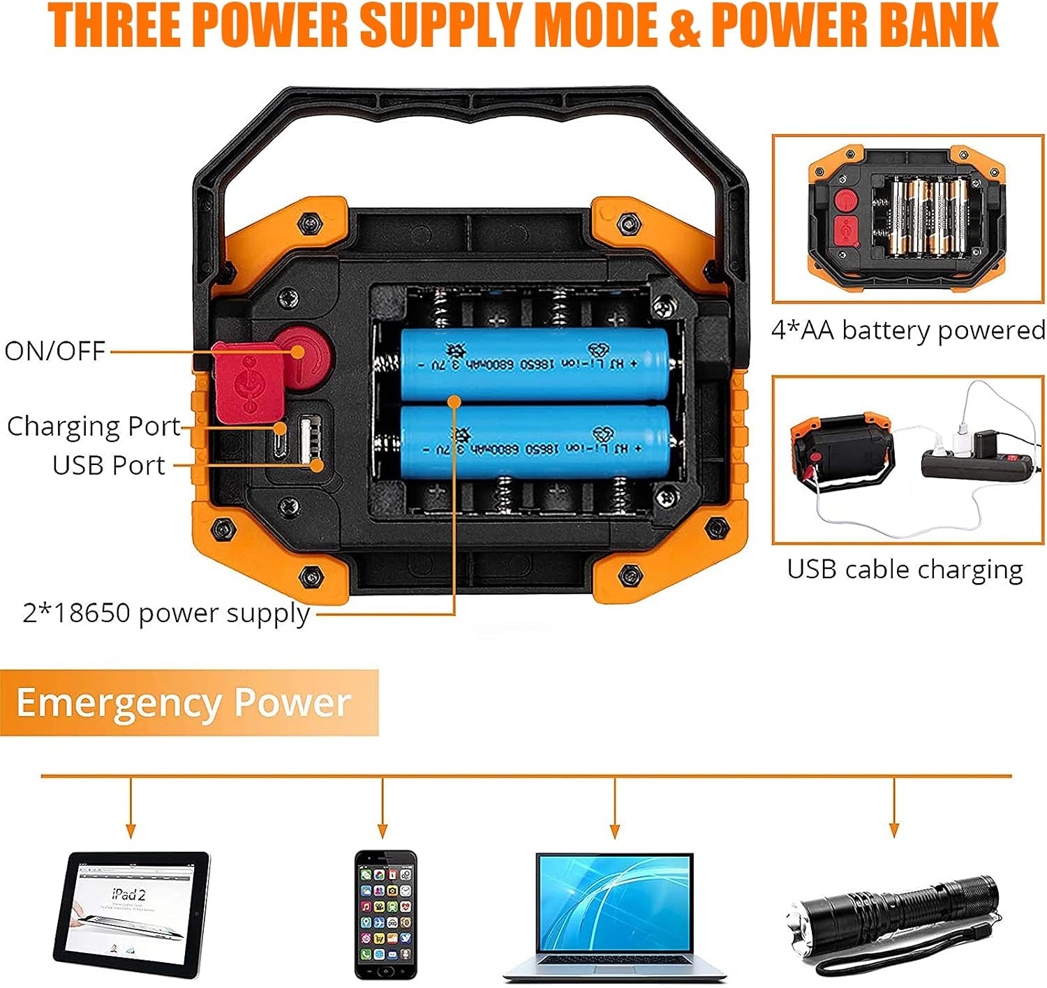

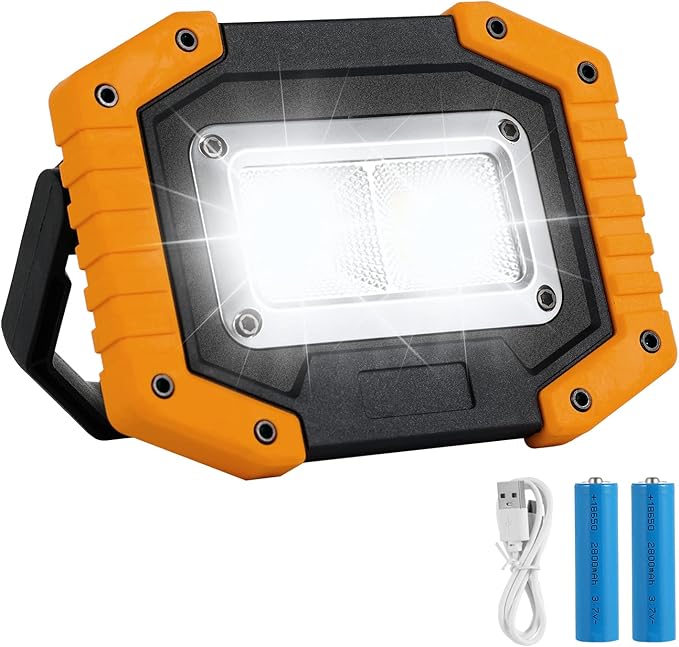

I've a suggestion for a cheap way of implementing a USB powerbank, AA charger and 18650 charger all in one. Indeed, it's almost a free solution ( about £15 or £25 for two ) :-
£15 gets you one bright LED lamp with all these features built in, even includes 2 x 18650 batteries.
Various amazon sellers, some sell these in pairs: Some include or exclude the 18650 cells.
Feature all the functionalonality of a USB power bank. Links below.
The lamps will work off one or two 18650's (Included) or four AA cells. It can be charged by any USB-A source and can be used to power any USB-A or micro USB device. Sadly they don't feature USB-C.
If you're thinking of charging AA cells and/or 18650 cells, and want all that functionality in-one place, you won't go far wrong with this.

These great little lamps are cheap and cheerful and not very rain resistant. The 18650s are low capacity.71dM669pLgL._AC_SL1500_.jpg71c8D7ciCqL._AC_SX679_.jpg
Link to a specific seller, which may expire
Link to the search terms to find these lamps.
Sorry, I should have been clearer. I already have power banks, an AA charger, and a 18650 charger. I just need a solar panel that will charge them all. Goal Zero have a good rep but are expensive. The one I have in my Amazon basket is a lot cheaper and has good reviews, so I might get that. One of my powerbanks does have solar, but I've never tried it.
