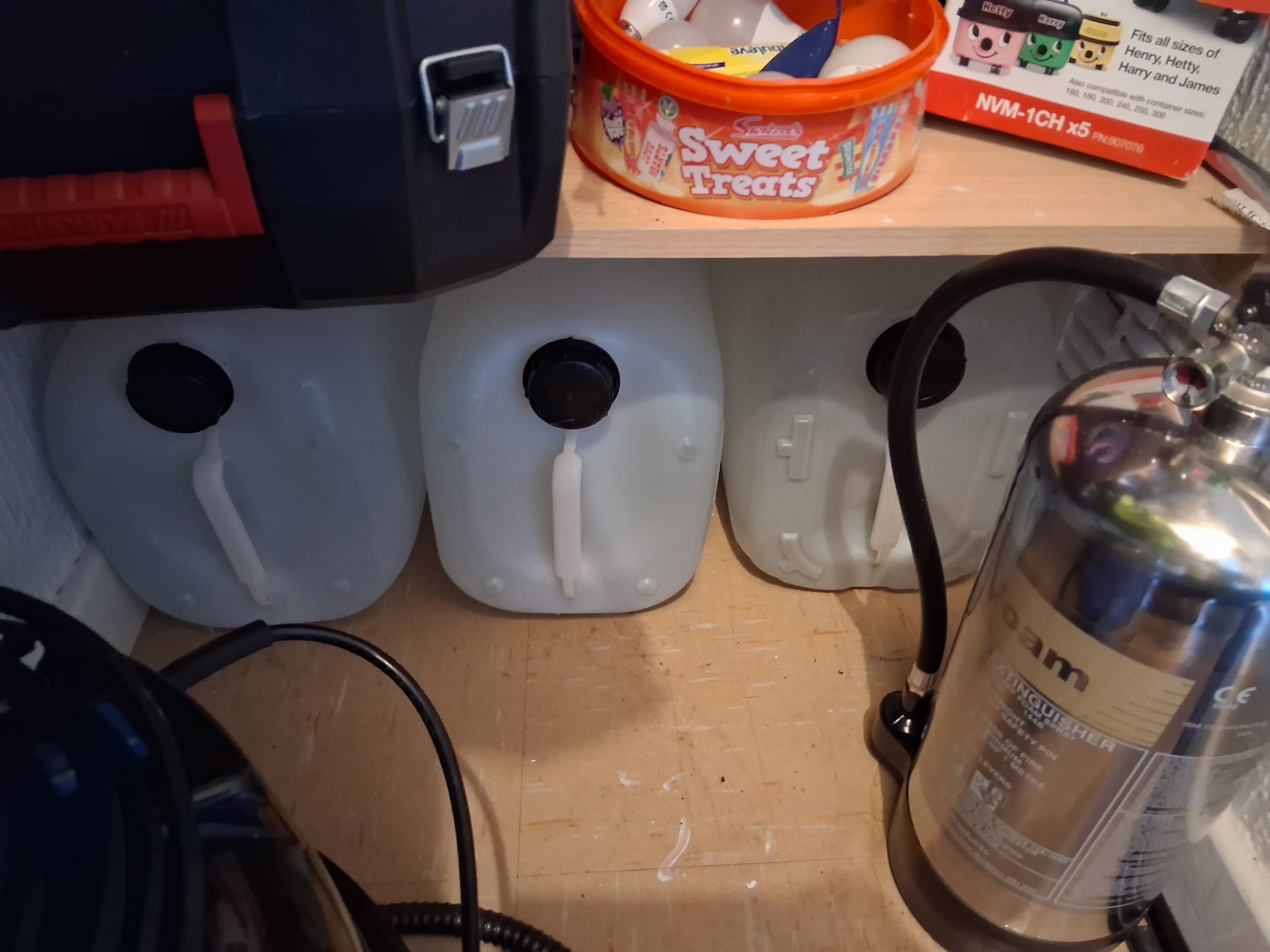

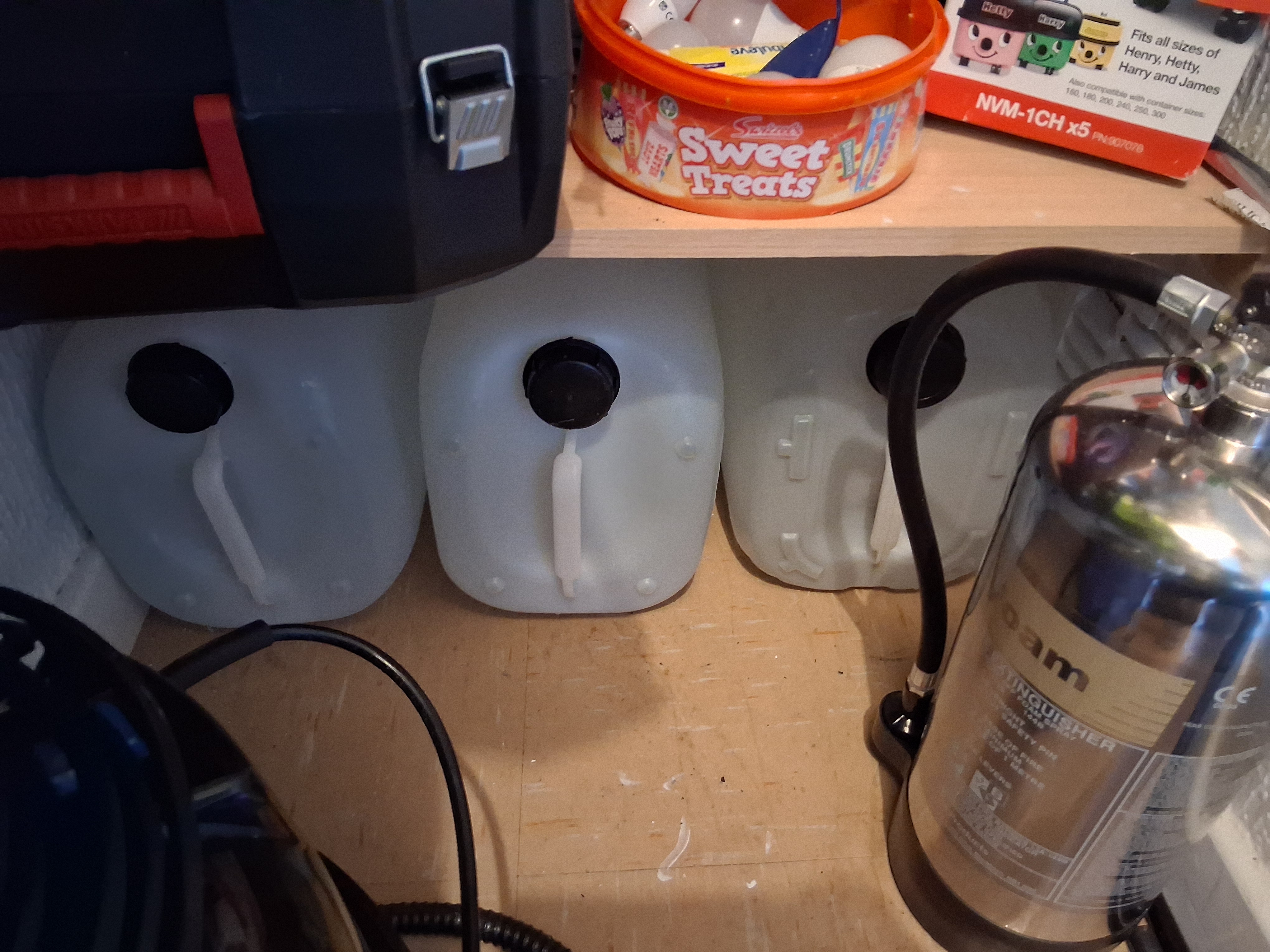

Water stocks tipped out and refilled
Water....the jerrycans, that’s what I need to do, and empty and clean out the muck in the waterbutts, our backup.
- Posts: 9888
They might be heavy but the 25l fit the space well added bonus is the cupboard under the stairs is concrete so weight isn't an issue
I've also got a drum tap so if needed decanting/ using is easy
Main storage are 25litre jerrycans in the garage, I have a 12v submersible pump from a camping shop I can drop in them,
but have got some 10litre cans which would be easier to handle (and by mrs P, on an everyday basis).
