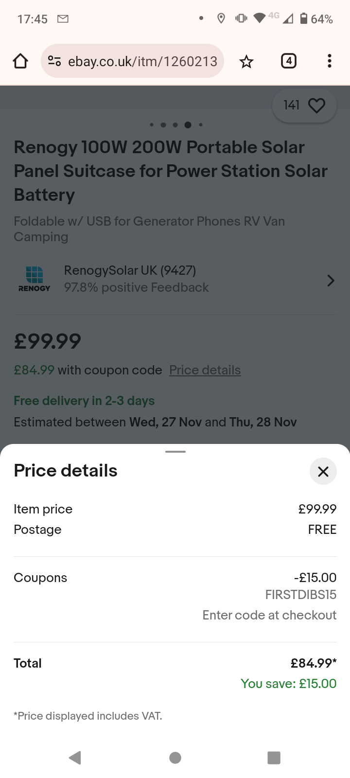

£84.99 at the moment Jenny which is why I mentioned it :mrgreen:
Cracking price. 8-)

Ok, the Renology one sounds good. Price has gone back to £99, so I might leave it a bit. It says a charge controller is needed to charge batteries. I looked at their page on charge controllers and it's mega complicated. I thought I could just plug my powerbanks and battery chargers straight in? https://www.renogy.com/blog/solar-charg ... oose-one-/

Yes. Discount code has gone away.
