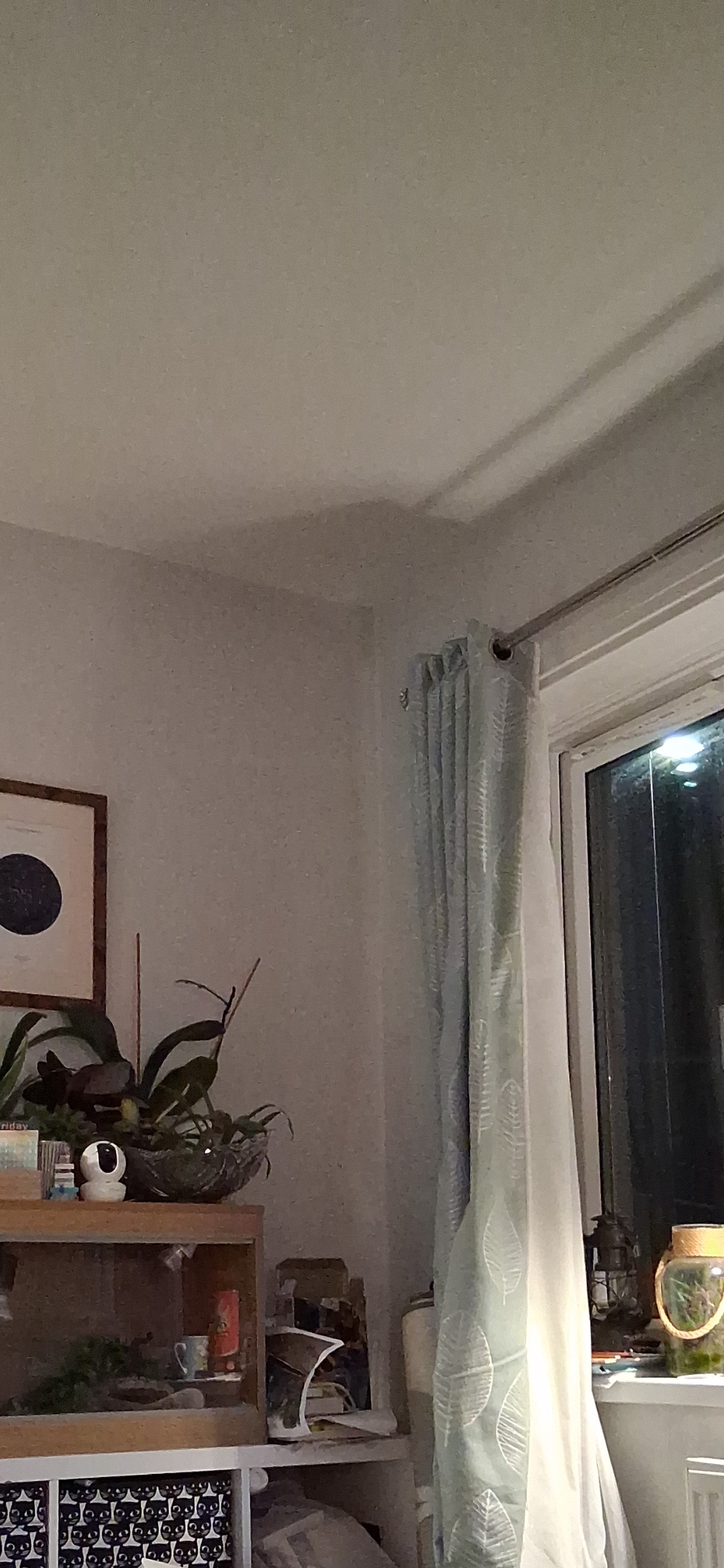

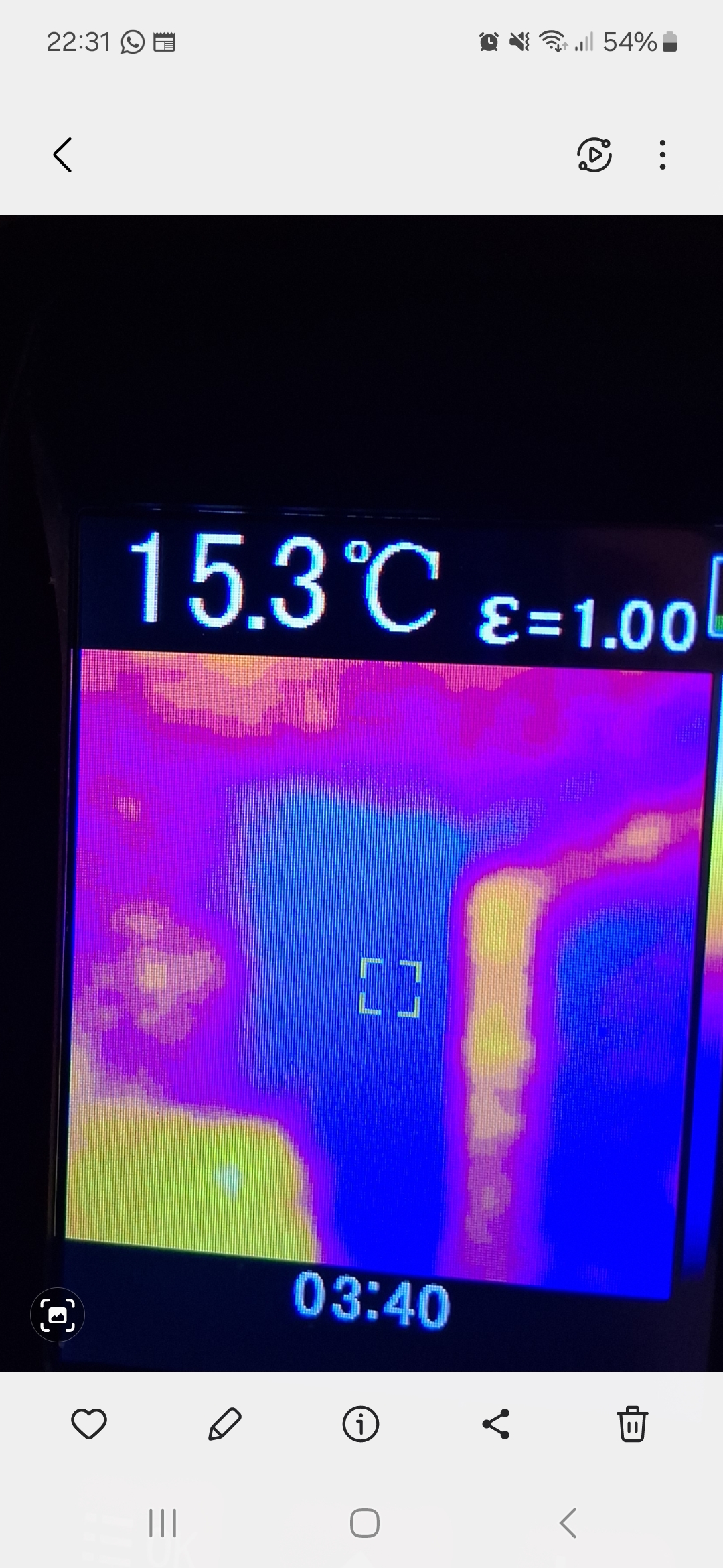

I got a second hand lidl parkside one it's adequate.. found a fire waiting to happen so it's paid for itself.. not the best resolution but if works ..
This is the corner of our lounge..
The wall above the vivarium isn't insulated the wall over the window has grenfell type pir cladding
You can see where next doors party wall joins (the houses are stepped)
