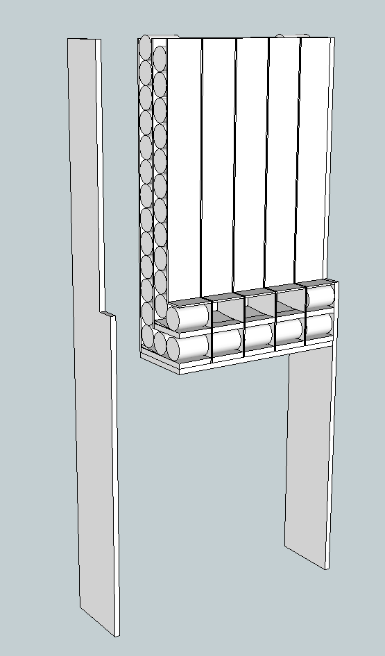

So, I saw and searched a few can storage ideas and had one problem with them all, they all stuck out like mad and took up a lot of floor space. I don't have too much of that but generally you find the vertical being less utilised so I decided to have a go at designing something.
I have a small utility that stays lovely and cool even in summer as we have pretty much turned the radiator in there completely off so no heating. Design below is based on the unit sitting above the current radiator as I would be hard pressed to get the missus to let me take the rad out and double stack the units :lol:
The design is componentised such that the width is only dependant on how many units you can fit and the design allows for a double stack (with space to get cans in the bottom row) by adjusting the height of the outside panels. If going for more than 5 sections in width, I would probably add another central end panel to ensure a solid unit.
In total using the sample can component, the unit can hold around 130 cans in the configuration shown with 27 standard cans per vertical component. I haven't yet figured the best means for stopping the cans as a ledge or wedge would limit the ability to get the cans out of the unit easily, I will probably try a few configurations when I get something built. I also plan to put two strips of door draught sealer in the verticals to reduce damage to the cans by slowing the fall to the top can.
General Dimensions:
Overall Height : 1.8m
Overall Width : 70cm
Overall Depth : 24cm
Weight : It'll be bloody heavy for sure!!
Construction : 3,6,12,18mm MDF
Any comments/suggestions/flames welcomed and if anyone wants the source file, I use Google Sketchup for this sort of stuff so if you can use that, you can mess around with the components yourself.
P.S the design is true scale and therefore accurate for cutting relevant board, given I have a glut of spare MDF in 12,18mm depths that's what I will be using.

Design looks good, but (there's always a "but" :D ) looking at the bottom of the diagram, what damage would be caused to tins four and five by dropping more tins down slots.
Also would that forth tin be able to move with the weight of all the other tins pushing down on it?

Given my particular house, we don't have a lot of floor space so the more horizontally focused ones can be used but I won't end up with the same density of cans in the overall volume. Also to the potential damage from the vertical drop, I am betting on the inclusion of the foam door sealer strips to slow the cans down. Still details to work out :)
