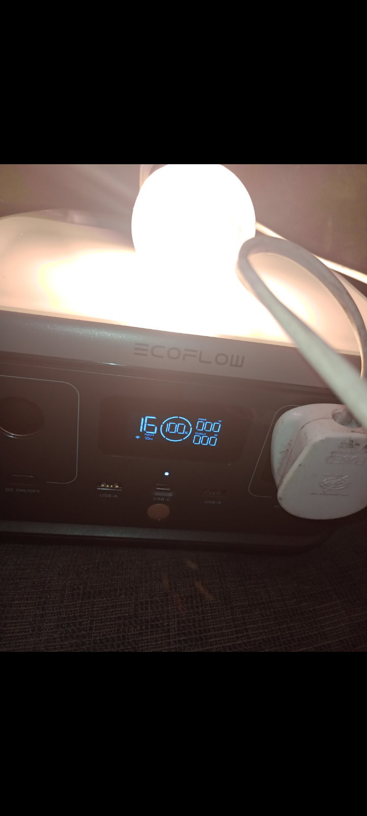

Re: Ecoflow river 2
3.6w filament led lamp equivalent to 40w tungsten filament... (Mains)
16+ hours
Need to dig the usb bulb out and see how long it will run that
And do a play to see if the 12v / mains camping TV will run longer on 12v or mains .... The household TV is just an experiment but keeping the kids happy and content will be important if the grid goes down for both my sanity and their safety I mean happiness and contentment plus they will stay out the way when off grid cooking for example which obviously has some inherent extra risk
The 1hr recharge time if the grid comes back up or I fire the generator up is another advantage
16+ hours
