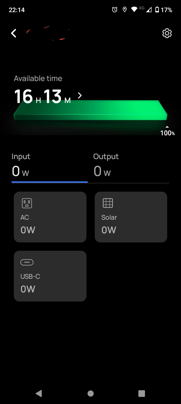

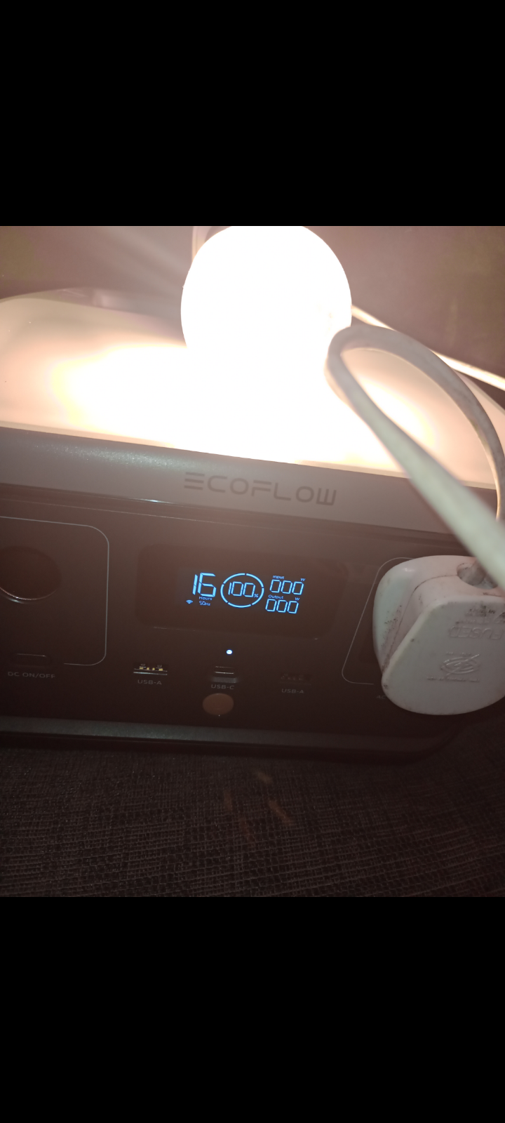

3.6w filament led lamp equivalent to 40w tungsten filament... (Mains)
16+ hours
Need to dig the usb bulb out and see how long it will run that
And do a play to see if the 12v / mains camping TV will run longer on 12v or mains .... The household TV is just an experiment but keeping the kids happy and content will be important if the grid goes down for both my sanity and their safety
I mean happiness and contentment plus they will stay out the way when off grid cooking for example which obviously has some inherent extra risk
The 1hr recharge time if the grid comes back up or I fire the generator up is another advantage
16+ hours

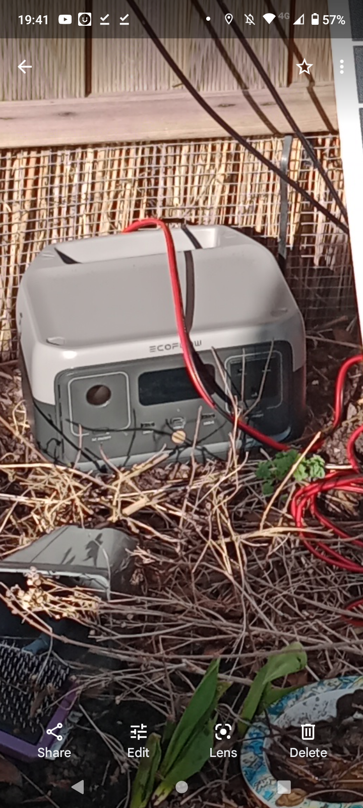

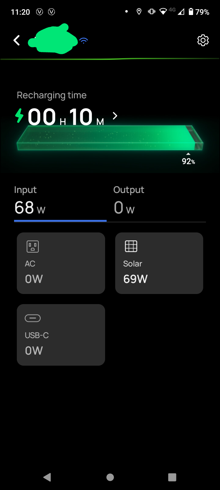

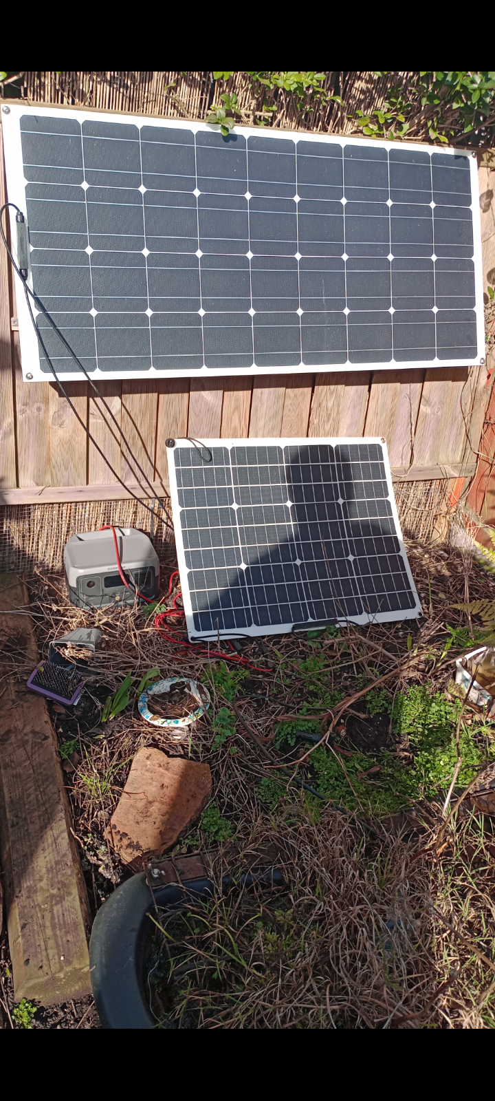

Had a bit of time this morning and the weak spring sunshine made an appearance
So I dropped the ecoflow to 89% was aiming for 90% but got distracted by paw patrol and a missing pup in a toy box
So anyway hooked it up to a total of 150w of panels it's rated at 110w input but the weak sun reduced the panels full capacity...
So in under 15 minutes it had put the 11% charge back into the battery
As the cooling fan cut in it must have been pulling a watt if power away from the battery hence the 1w loss
Did get a few bits of cloud drifting across the sky and shadows cast taking pictures
so it dropped a bit of wattage as and when hence the 15 minutes but I'm happy with that
