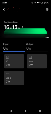

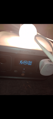

Re: Ecoflow river 2
3.6w filament led lamp equivalent to 40w tungsten filament... (Mains)
16+ hours
Need to dig the usb bulb out and see how long it will run that

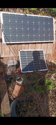

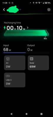

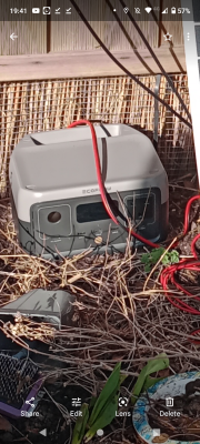

Had a bit of time this morning and the weak spring sunshine made an appearance
So I dropped the ecoflow to 89% was aiming for 90% but got distracted by paw patrol and a missing pup in a toy box
So anyway hooked it up to a total of 150w of panels it's rated at 110w input but the weak sun reduced the panels full capacity...
So in under 15 minutes it had put the 11% charge back into the battery
As the cooling fan cut in it must have been pulling a watt if power away from the battery hence the 1w loss
Did get a few bits of cloud drifting across the sky and shadows cast taking pictures
so it dropped a bit of wattage as and when hence the 15 minutes but I'm happy with that
